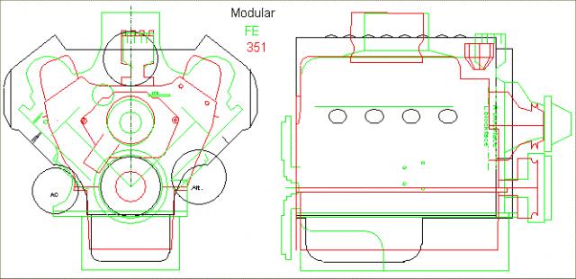

Donn, here's a visual which might help - 351, FE and Ford modular. I'm no expert but I would guess the SOHC 427 cammer is a tad bigger in terms of breadth and height than the FE, but smaller than the modular. Again, I don't really know - there are lots of folks here who would know however.
Sounds like there are a lot fo Roush 427s in SPF cars, so, I'd guess that the main limit (if there is one) is the additional height related to the separate cam and drive, and whether that all fits under the internal horizontal part of the clam shell....

Standard 427 is 23" wide, SOHC is 30", same as the DOHC Mod Motor ( SOHC Mod is 25 5/8 ) Height of 427 SOHC from crank centerline to carb pad is 15"
Hope this helps, Mike

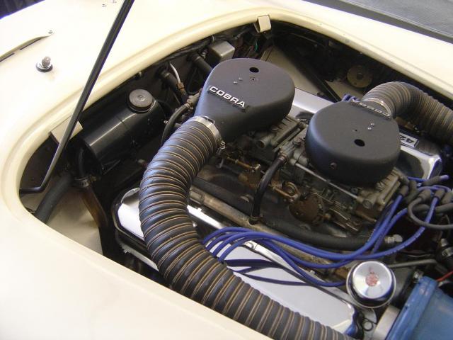

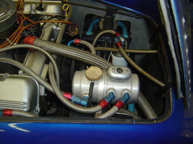

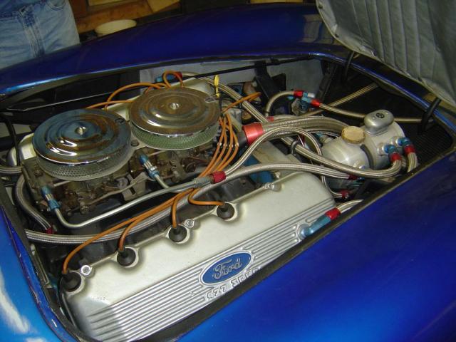

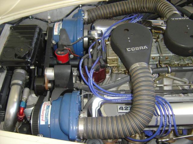

A good friend of mine has many of them and parts that go with them in San Diego, they are huge!! I just can't see one in a GT40 but I have been proven wrong more than once. I did see one shoe horned into a cobra, it was a crazy project but sure consumed the entire engine compartment. I have pictures somewhere.
Cobras are easy. It can be done in a GT40 but its alot of work. We have the engines.
