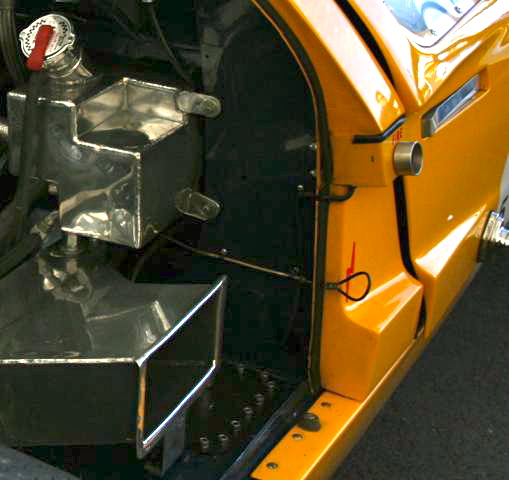

What is the fixture behind the driver's door, shown here on P1077 (Yamaha car)?
Is it a lock? Light? Quick door opener? Security?

Dalton:
It looks like a master power cut of switch. There is what looks to be a little red key hanging on a lanyard in the on photo.
Regards Dave
Dalton:
Regards Dave
That would be my presumption as well.
If the car is used in sanctioned competition, I believe that they may require an external power master switch due to the car not having open windows/access to an internal switch.
Dave Collins

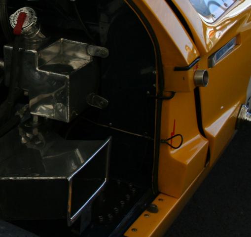

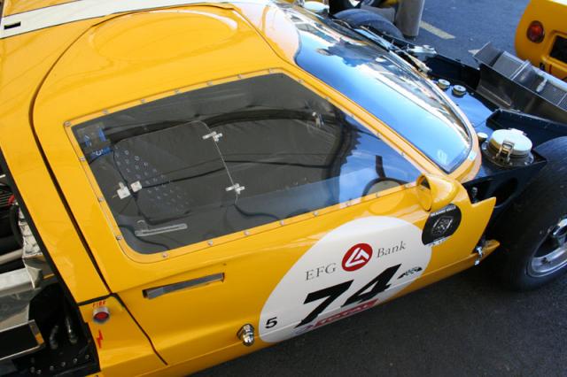

Hi,
Attached photos shows that it is a push button for the fire extinguisher and then some sort of pull cord for the electrical cut off.
Dave

Dave's last image enhanced slightly
