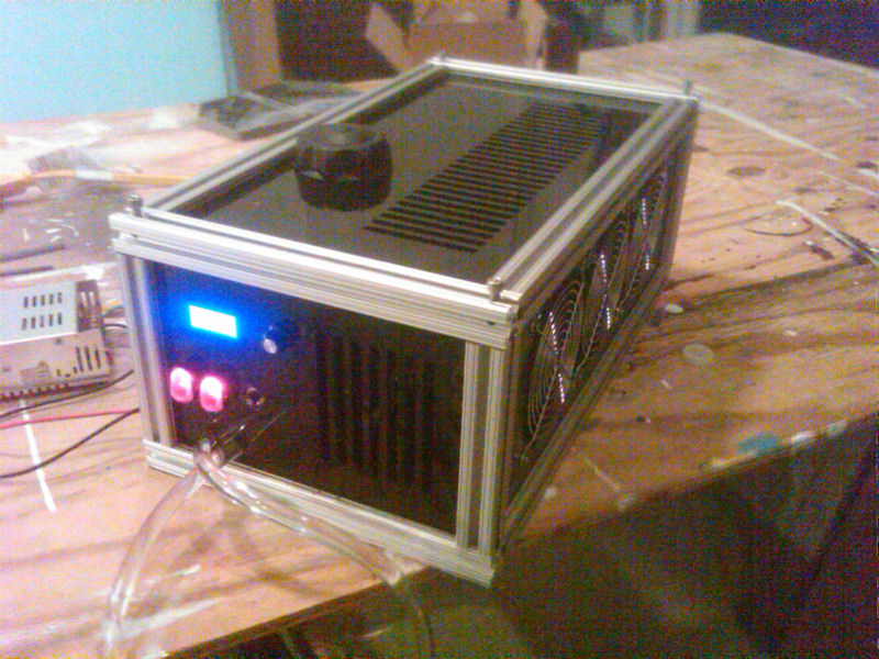

After a couple of different designs we finally came up with a system that seems to work well. It can chill the coolant down to freezing in about 15 mins in an unloaded system and with a cool shirt hooked up and a human inside it can maintain 9-13C, plenty enough to be cold when you are in the shirt. It has a small coolant reservoir inside and in theory you'd only have to add water to replace what gets lost hooking and unhooking the dry break connectors, which should last several weekends without water addtion.
The box below is the final design with a couple of extra like a three position temperature monitor (inflow coolant, heat engine hot/cold side), dry break connectors, and the possibility to switch it to a heating mode (not sure what the hell that would be used for!). All in all it has tested on the bench well and seems to do the job. I'm going to install it in the race car and try it out for next season.

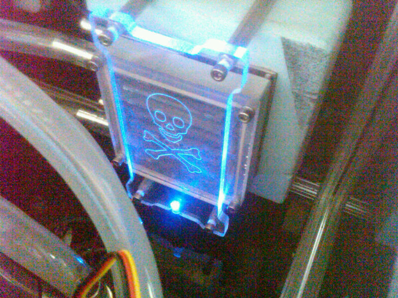

The unit is fairly large, 20x10x7 and weighs about 14lbs. Not sure we could make it a lot lighter as it has a radiator, two liquid systems, two pumps, heat engine, four fans, plus breakers, switches, and of course the lighted pirate skull that was necessary to make it all work. Deon did a nice job with the CNC side of things, especially the skull.

I'll be interested in how it works in the race car. 10 lbs of ice used to last 45-60 minutes when I did IMSA endurance races in a closed car. 14 lbs is not bad. Guess the question is how well the heat exchange occurs in a hot car. How do you plan to duct the radiator?

Really impressive! Just curious: how much current does it draw? And what kind of pricing are you thinking about?
The unit works damn well. There are commercial versions of this out there, but they range from around $4k to $10k. All the same thing - Peltier device.
Current draw is significant, around 25 amps. But nothing is for free. If you need to move heat, you'll need power to do it.
Cost for an assembled unit? Not sure what Deon and I will do with it. Just the parts cost (retail) to put the unit together is up around $700-$850 or so, but I still need to complete the spreadsheet of every last bit. We designed and developed it with the intention to put together a sellable unit in a nice molded package for the $700-$1000 mark. At that price it'd be highly competitive with glorified ice chest systems (around $450) but have a number of distinct advantages. But, even if we can get the parts cost down to wholesale levels, $250-$300, we'd need to charge quite a bit more than $800 to sell them for any real business value. The labor to build it is intensive and I'm really not sure we could get the parts cost down to $300. In the end we have this working unit and if close friends of ours racing wish to have one we'll probably build one for them for a nominal fee.
