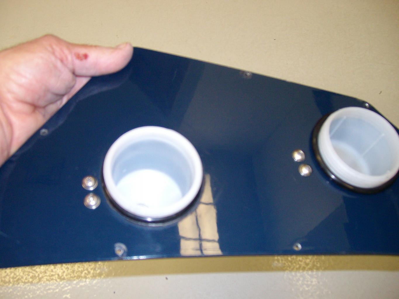

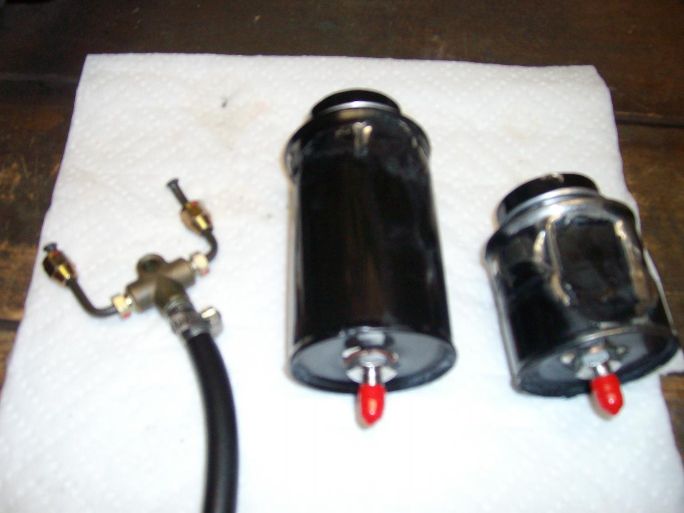

Got fed up with the weepage through the rubber hoses so took everything apart.
Used 2 Girling cannisters (7 oz for brakes and 5 oz for clutch). Opened the holes in original cover plate, used "O" rings top and bottom of the plate and "The Right Stuff" to glue/seal the cannisters and "O" rings to the plate (I called manufacturer of "The Right Stuff" and they said it would be a good adhesive and sealant against any brake fluid drips). The "Right Stuff" is teriffic...the cannisters are really locked in place) Wrapped friction tape around the cannisters and the original brackets after reforming them to match the Girlings profiles and then used the original hose clamps as a final precaution against rotation.
Running braided AN4 PTFE lines and AN4 fittings eliminating the SPF fragile hard line to rubber hose assy (used from the brake masters) routing directly to the masters.

Pic of removed metal cannisters and hard line to rubber hose connections from brake masters:

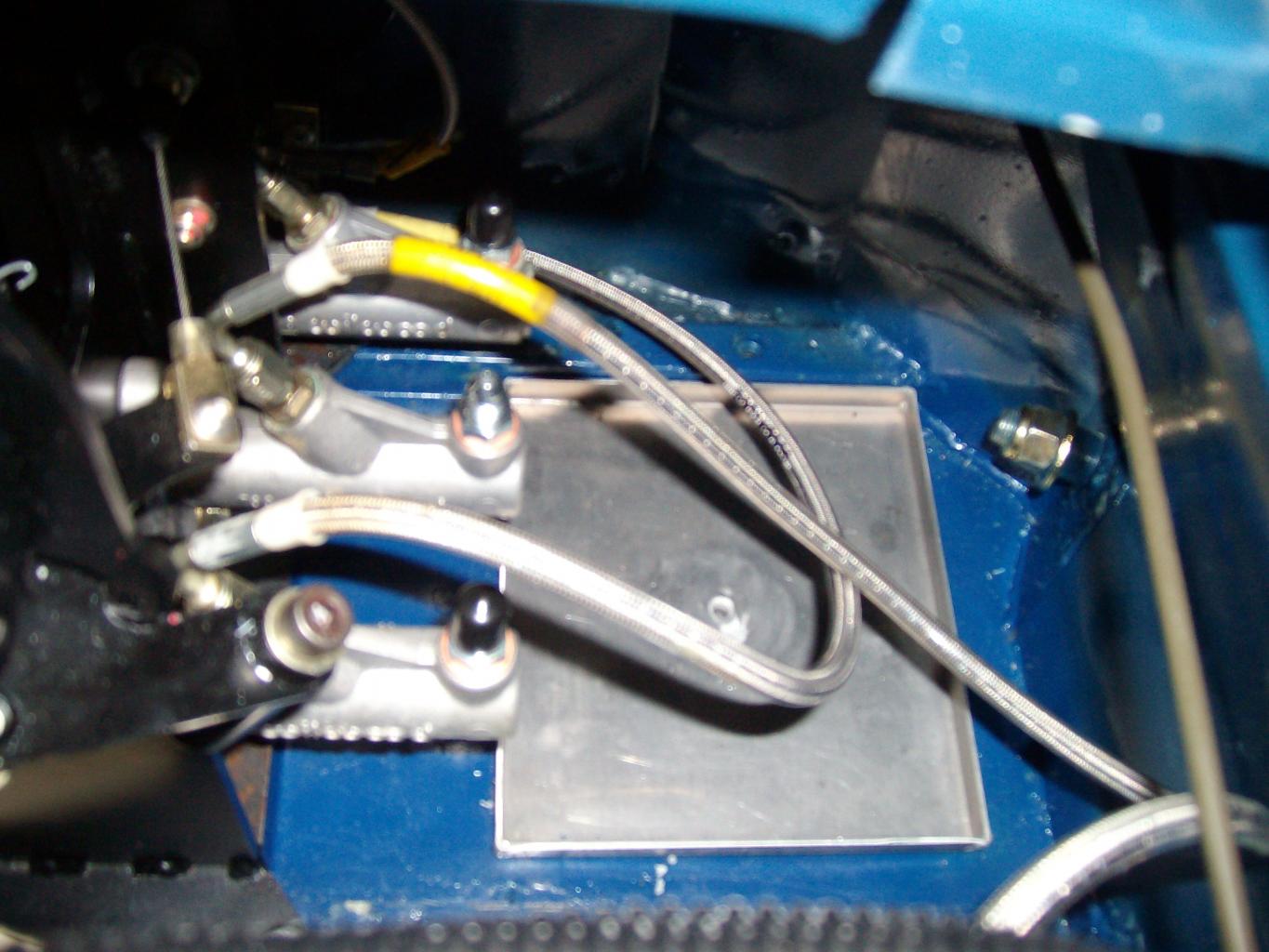

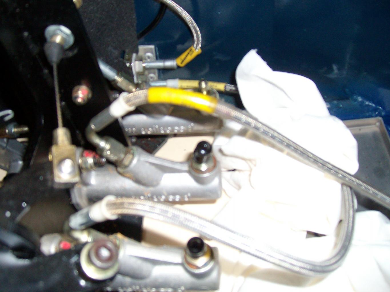

Pic of brake and clutch masters from access panel under AC evaporator

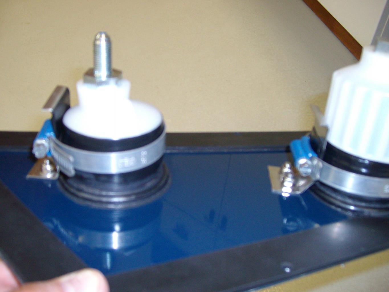

Pics of new Girling cannisters assembled to original cover plate

I went up and down on the sizes of the o-rings at the top cap neck and finally wrapped the ring base with tefflon tape to stop the seapage there. I double clamped the hose ends. The cap area has been dry for 4 years now. The hoses are showing slight weapage again, after 4 years.( SPF Daytona Coupe)

Did you use Buna N or Fluoroelastomer 'O' rings? Nice job. Sounds like a nice winter project, however since our chassis are only 1 number apart...

Grady: I used isoprene rubber O rings
See above post for pics of new Girling canisters assembled into modified original cover plate.

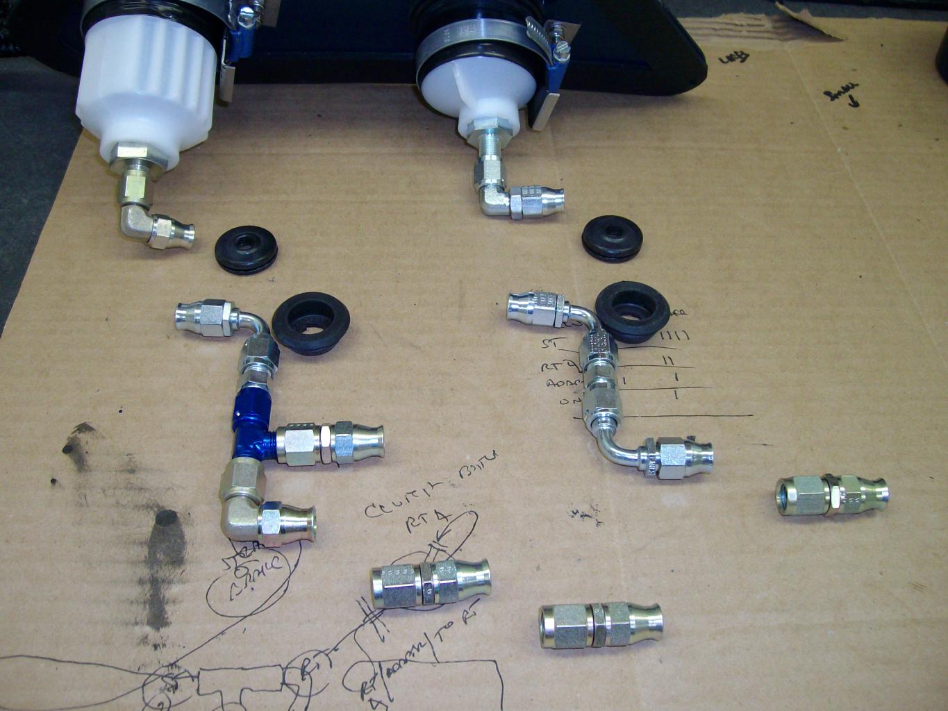

Pics attached of:
Drip tray with drain tube to collect any leakage from master cylinders and drain through the pan rather than collect (note pedal assembly pulled to rear for installation). Note new 7/16 to AN4 adapters installed on masters.
Layout of AN4 fittings that will connect the new Girling canisters to the masters (hose assembly and install tomorrow).

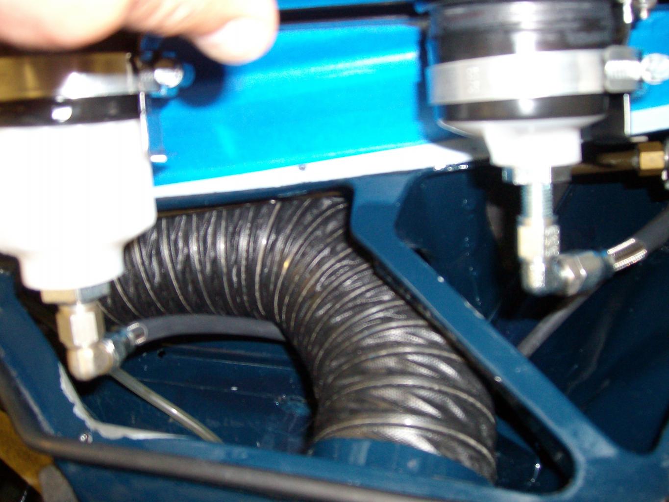

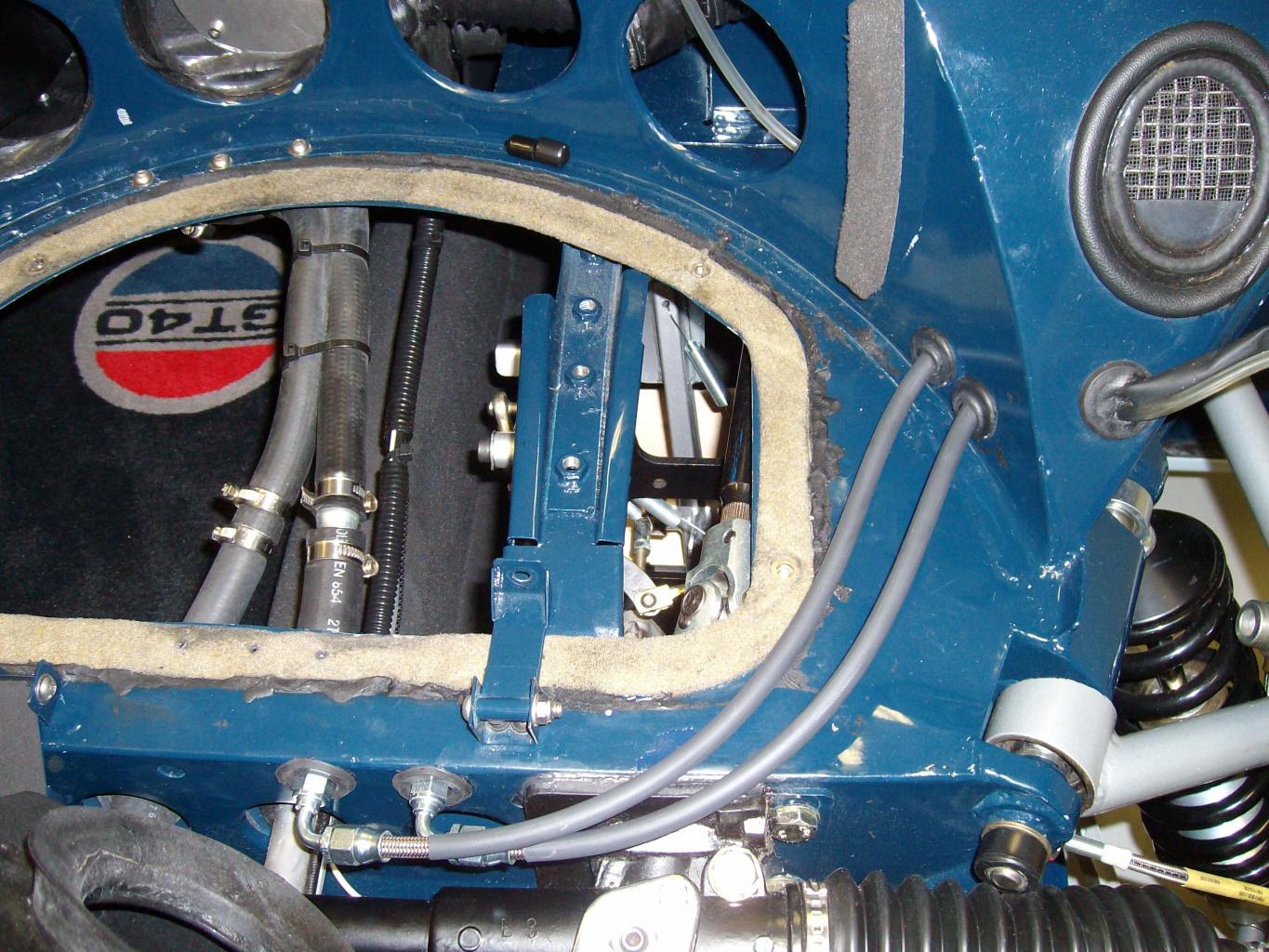

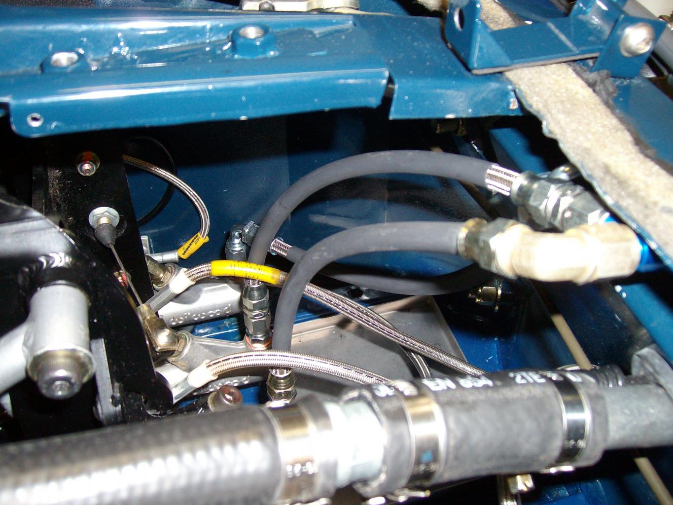

AN4 braided lines completed and covered in 1/2 shrink tube to prevent chafing of paint and other braided lines.
Pics of hose and fittings flat on floor and various shots of assembly.
Note pic of canister cover raised showing extra hose dressed to allow cover to be raised for inspection.
Hoses go through bulkhead mating AN females via a male to male adapter for the clutch and AN female to AN T with female on the run via another male to male adapter then to the masters as shown.
Hose dims follow (dims are exposed braided line, not including fittings):
Clutch canister to bulkhead 35" AN 90 each end and a male/male adapter at bulkhead
Brake canister to bulkhead 30 1/2" AN 90 each end and a male/male adapter at bulkhead and to female on the run of the T
Clutch line interior bulkhead to clutch MC 9" AN90 each end
Brake line interior bulkhead to center brake MC 9" AN straight each end ties to the male on the foot of the T
Brake line interior bulkhead to right brake MC 8" AN straight to the MC and AN90 to the male arm of the T
Canisters from Pegasus: Girling's as shown in their catalog and assembled as describen in earlier post above.

Pic of hose dress from canister wall to bulkhead:

Really nice!
What are the fittings at the cylinders? At the ends of your hoses it looks like you adapt from AN4 to one of the (various) hydraulic flare fittings, so I'm wondering what that is, and is it the same as up at the original girling cans?
Also you gotta quit showing me that blue painted chassis. It just gets me wondering how much work it would be to paint mine that color...:thumbsup:
Steve C
Steve
Alan,
Fittings @ the MC's are 7/16X20 inverted flares to 4AN with crush washers to 4AN .

One correcttion and change I made before final assembly:
Use straight bulkhead AN4 to AN4 not male to male adapters (gives more room to wrench the fittings at the bulkhead)
