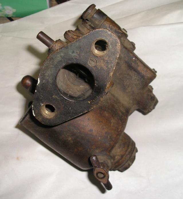

I think they are still in the process of digging up the carb for it from the dark ages ;)
No, I have it but they won't meet my price:
