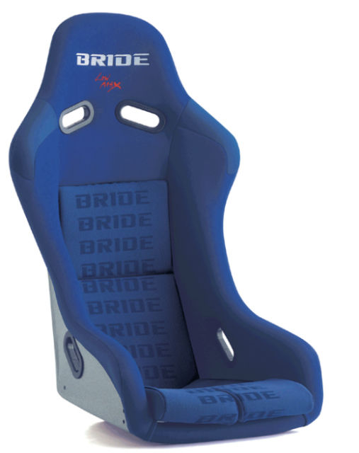

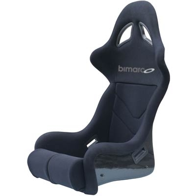

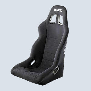

Hello I have been looking at possibly buying finished upholstered
seats as it could be less expensive then getting the factory seats custom upholstered.
We do not have very good assortment of seats here to look at and I was wondering if any one has tried any of these in their cars or would know if they would work in the SL-C or what did you use that worked, picture's would be great if you have them.
Cheers,

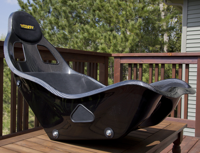

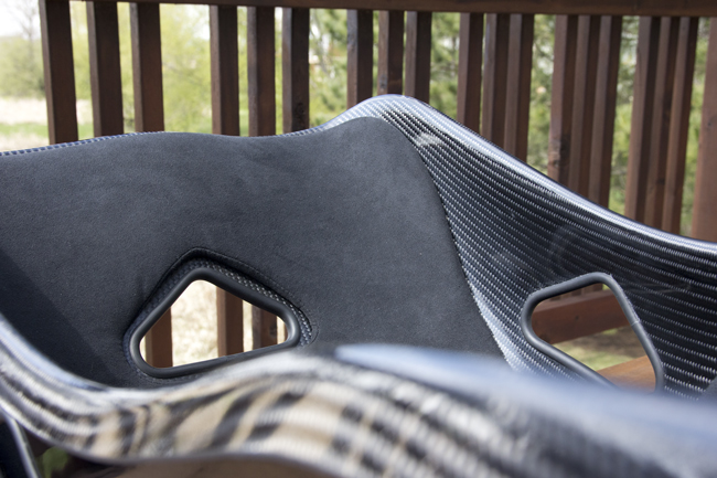

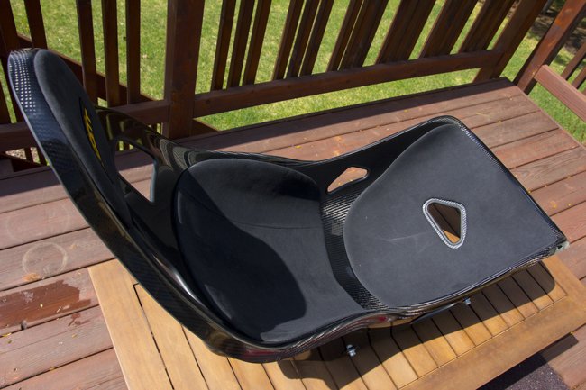

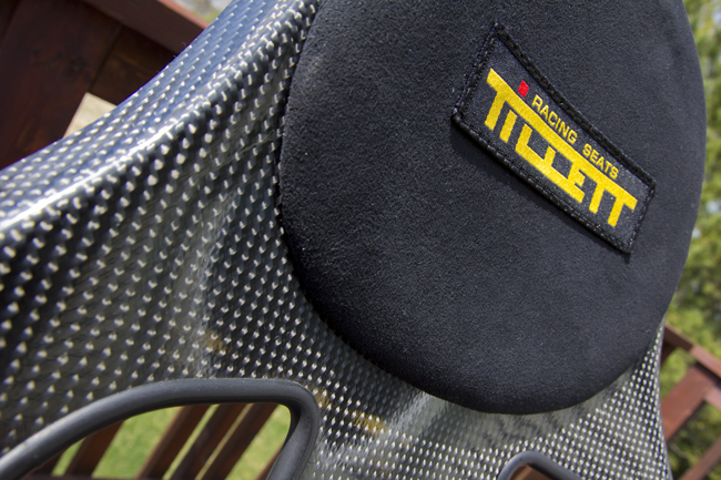

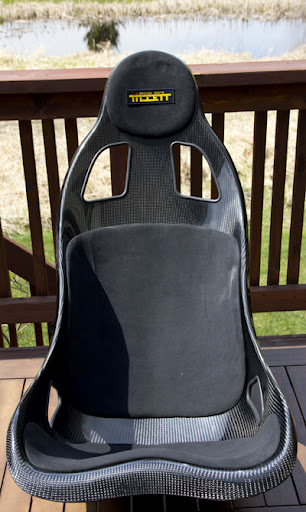

Here is a picture of the carbon fiber Tillett B5 going in my SLC this June. This seat can be used with a 3 point seat belt or a 5 point belt. Keep in mind that some States and Provinces do not allow a 5 point harness in a street driven car. I constructed the seat brackets from 1/4" thick aluminum rectangular tubing (cut in half) and the sliders are sold by OMP. Seat back angle is set at approx 45 degrees. If I track the car then I'll switch to solid mounted seat brackets if the rules dictate it. Complete seat as shown in picture is 22lbs.
Very nice Ken. I like your brackets. Nice, simple, and clean.
I also considered that seat but went with the B4 instead for more side bolstering. The B5 will be considerably easier to get in and out of though and allow for a bit more "gentleman" shaped guys.
I had the B5's in my Lotus, and absolutely loved them. Despite the lack of padding, they were extremely comfortable! Looks will fool you.
I liked them so much that I bought the B4's for my SL-C. They are quite narrow (i.e. not a "gentleman's" seat), so make sure to check the dimensions on their web site before plunking down the cash.
