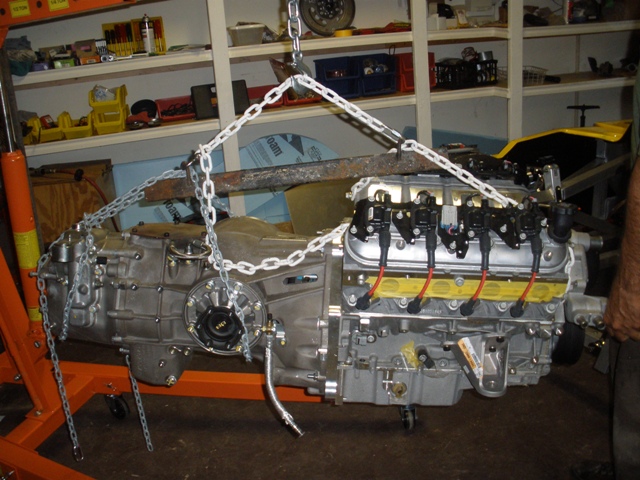

I use the intake plate method on a alum intake every time I pull the engine. No problem, even with the gearbox attached to the motor.
No need for a fancy $100 plate, a tow bar works!
