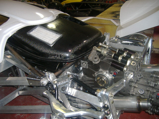

The LMP-C cars used in ALMS use LS engines with the forward facing intake, they use a 90 deg. cast aluminum elbow to point the air inlet vertically....if you really want to try it..
The roof scoop, unless modified and the inlet moved forward to the leading edge of the roof will not provide enough volume/flow unless your airbox is a large sealed plenum...similar to using a restrictor and having a large airbox full of air as a reserve...ALMS Corvette C6R style...
We have done a carbon airbox for a race SLC and the air intakes are actually on the rear window area of the tail...

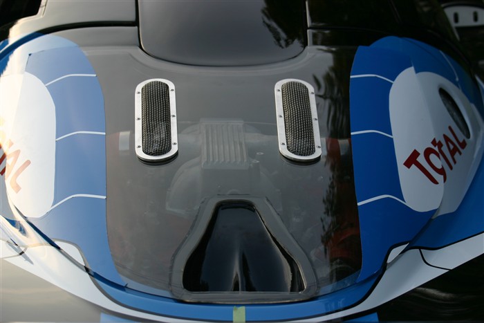

How about a couple of side ducts glassed into the rear clam like the ones Shane makes for the GTM? They are set up for routing the air where required. I am sure they could be adapted to the SLC...in fact, I think someone here has already used them on one, but I can't remember who. Help!
Here are a couple of pics...

Exactly the same reason the vent is there on the Le Mans.
It also acts as a chimney when the car is stationary allowing heat to escape also...sounds crazy but its true

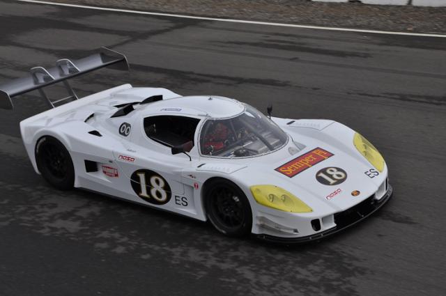

So the Eagle is going to burn up, huh? Looks like its original roof scoop is completely blocked off, and the new engine air scoops don't ventilate the engine bay at all.
Why would the #18 car burn up?...it does not have the same extra street car bumph stuck all over the inside of the body for sound deadening and NVH as the Ferrari or the Macca
The tail is lifted off just about any race car just as soon as they enter the pits generally, less of a heat soak issue....... the airflow still flows through the side scoops and exits the rear of the car when its on track and moving...
You will see that the lower section of the tail section has been completely removed allowing even more air flow out of the engine bay, which in turn means better cooling...my 01 car is the same way...huh!

Or maybe you don't get my sense of humor. I'm just giving you a hard time for pointing at the the high dollar establishment's public humiliation by fire as a design rationale for the roof scoop when #18 seems to do fine without it.
That little scoop really makes that much difference in non-race configurations? Haven't some SLC builders done fine with the scoop not plumbed through to the engine bay? I'm not really just trying to give you a hard time, but I am curious about how amenable the car is to having the scoop eliminated or re-purposed.
