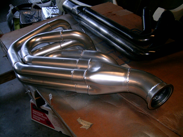

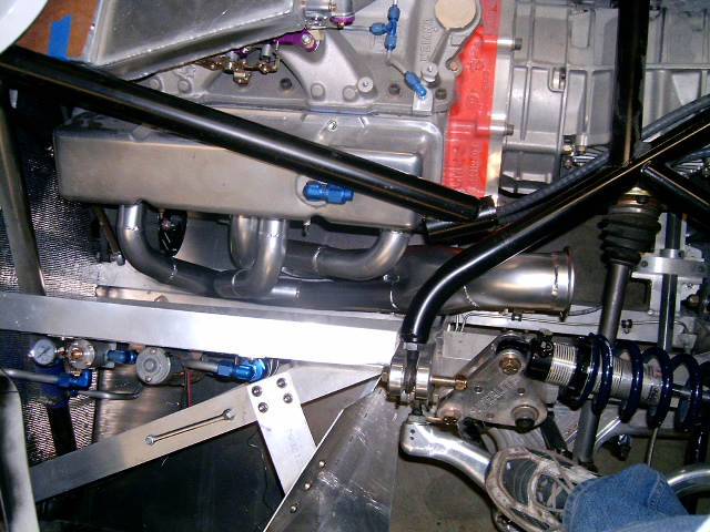

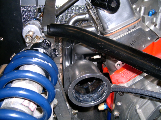

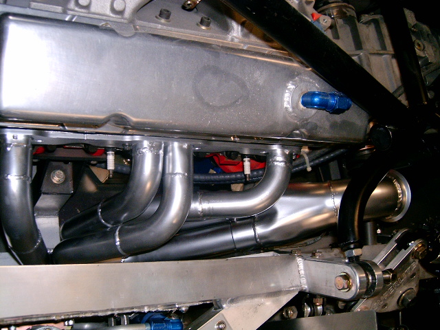

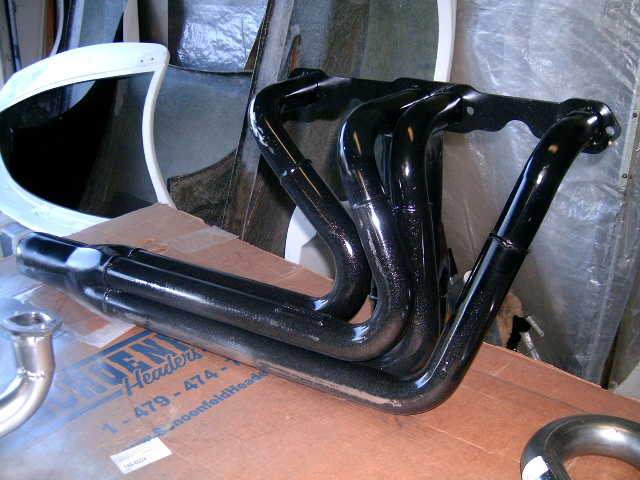

Here's some pictures of mine. Granted I have used a ol school SBC but you can see the basic configuation. My primary lenght target was 32-34 inches. I was easy to do this for 3 out of 4 pipes in my case. The 4th was difficult because I used a set of sprint car headers as donners. If I make them again and little better planning and it will be easy to get near equal 33 inch pipes. I think you could go as long as 36 inches if you wanted to. 32 is a pretty good number for a >7000rpm motor.
These are 1 5/8 then 1 3/4 into a 3 inch collector. The planned rev range is 3800 to 6600 and about 450HP.

I would recommend that you have the car with the engine in it before you begin building headers. Otherwise I would say you have less that a 25% chance of them fitting correctly. This isn't really hard to do but it does take a LOT of trial and fit, over and over again. You need the car for the trial and fit part.
I don't quite get the idea of purposely building unequal length primaries. I have never seen this done on purpose, although I freely admit I only know what I have read on header construction and theory and my limmited number of sets I made myself (1 V8 and a bunch of 2 stroke expansion chambers a long time ago). Are you trying to do a 180 design? I think it can be done with a Porsche size GRBX but not so much with a Recardo. I would steer you towards a H pipe design. Very little difference in performance and sound but less than 50% of the work IMHO.
The last thing is the area you are working with isn't square. The upper and lower chassis tubes are not equal distance from the head exaust port surface nor are they straight fore and aft as far as the same distance from the heads at each end. You also have quite a bit of additional clearance below the head ports and the block. Then where you mount the alternator and other accessories must be taken into account. There's plenty of room but its not a simple rectangle box you will need to work in.
