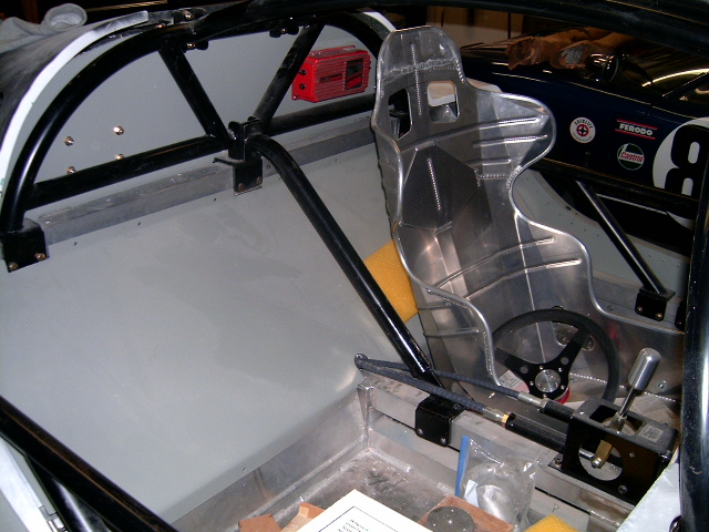

You all know this is a track car so I asked Fran to send me some more cage pieces to give it just a little more strength if I'm in a high speed barrel roll through the grass.
I tacked the front bar and dash bar in place in the car.
My son and I took the cage out of the car and went to my "dirty" garage to add the rear bars and finish the welds.
Here is the naked shell, although there is still more that could be removed.
If you think there needs to be another bar added somewhere, now is the time to talk about. What do you guys think?
Dlampe is offline

Hey dean I have never built a roll cage. But I do know about structural support thanks to my dad. I would put two maybe three bars between the roof bars. I would also put a petty bar from the passanger side roof bar at were it joins at the rear hoop. Then I would weld it as close to possible to were the roll cage meets the chassie on the passenger side. I might also do a x member on the passanger side door bar. I would attatch it from the front hoop to the door bar. Then do the same for the rear hoop to the door bar. If you can I would also do that on the drivers side. Also don't forget the gussets.
tipptruck1 is offline

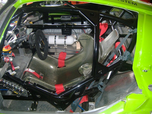

If you think there needs to be another bar added somewhere, now is the time to talk about. What do you guys think?<!-- google_ad_section_end -->
Dean, the 01 car did a nice job of surroundning the drivers helmet. Might make it a bit of a limbo gettin in tho...

I have sat in the 01 car and it is a little bit of a deal getting in and out. I didn't want the full cage for the track day car. I have been in the shop today working on the steering mount and looking at the cage and really trying to evaluate how much is enough. I think its good for a amateur race car. I say that because the GT40 looked like this.
The top side bars are removable. This car was in a massive accident. It rolled twice in the air before rolling 2 1/2 times on the ground before coming to rest upside down. My buddy walked away with bruises where the seat belts held him. The cage did such a great job of protecting him and the car that it is completely rebuilt and ready for the track in the spring. I think the SLC cage is already stronger than the one in the picture.
I really think that if I had a roll over, the cage would protect me. Those are some thick wall tubes. I was surprised at how heavy the cage is when I'm moving it around in the garage.
You could gusset the corners between the front and rear hoops and lengthwise roof bars. You could also add a bar (or two) running side-to-side (perpindicular) in the middle of the roofbars and perhaps even skip weld a steel sheet along its length.
The rear hoop could nave another attachment point at the bottom center like mine and Howards.
I need some of those newer door bars you guys have. I have the older style. Not sure which would be more effective protection in a worst case scenario, but installation without hacking up the door sure is a bonus.
