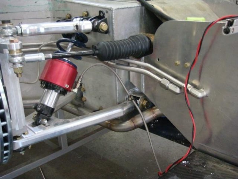

Anyone with pictures of it? Curious how it works as I am ordering the kit with it. Might be ordering here very soon as my Elise might be sold this weekend, so good news for Fran and Me or should I say Me and then Fran.
I've been trying to wait for someone from the SLC crowd to post, but here are a couple of pictures and a video of my car, to show how the lift works. I am using the RamLift Pro, which Fran sells. I'm from the GTM crowd, but I see an SLC in my not so distant future. So here you go. When I bought mine, Fran didn't have any in stock, but pointed me toward his supplier in order to buy direct...
As you can see in the pictures, the ram is fitted on the lower perch, below the spring. When it is activated, it pushes up on the spring, causing the shocks to extend, lifting the car. It gives me a couple of inches of lift at the nose.
The GTM normally uses 8" springs, but with the RamLift, I'm using 6" Eibach springs. The Shocks are Genesis Racing Shocks, uniquely valved for my car. Sourced by QRP (Quick Racing Products). The owner, Ted Harrison, happens to be a recent owner of a couple of SLC's. One coupe and one LeMans version.

Makes sense to me now that I can see it.

Re: Hyd.front lift
I've got more. Just let me know if you require more. I've also got photos of the pump and whatnot.

I used a complete custom Kooks header and exhaust system that was designed for the GTM. The warm and fuzzy feeling that you mentioned comes from the cross pipe and mufflers. I have the entire system ceramic coated.
If I'm not mistaken, Shane Vacek of V-Raptor Speedworks is working on having a similar system developed for the SLC. But I'm not 100% sure. I'm pretty sure that he's a vendor here.
Roberto (Stage 7) also has some mean skills at manufacturing headers for the SLC.
Dyno Run:
Here's a Dyno run that might give you a better sense of how it sounds when it's stretching it's legs...
http://www.youtube.com/watch?NR=1&fe...&v=eovwIUakKJo
RamLift Pro Pump:
The Ram Lift Pump was mounted on the driver's side frame wall at the control arm mounts. The pump reservoir is mounted on the block off panel behind the radiator.
The system is activated by a toggle switch mounted on the console. I'll probably change it to a momentary switch though.

Thanks for the photos. I'm looking for ideas on where to put mine, so your placement is quite informative.
You should get in touch with Roberto (Stage 7). He mounted his, on the opposite side wall of the front compartment. In this pic, you can see the pump and reservoir on the left side.
