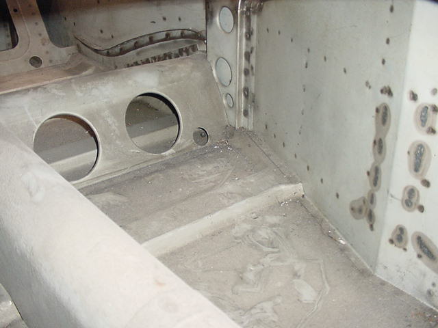

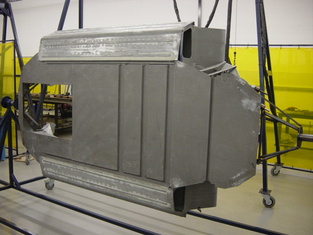

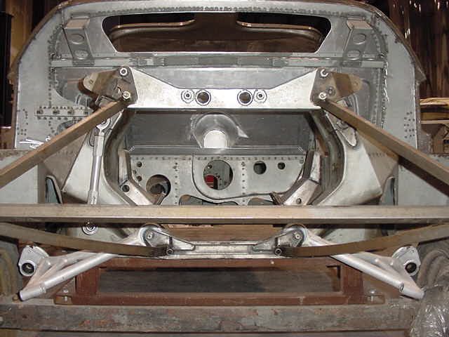

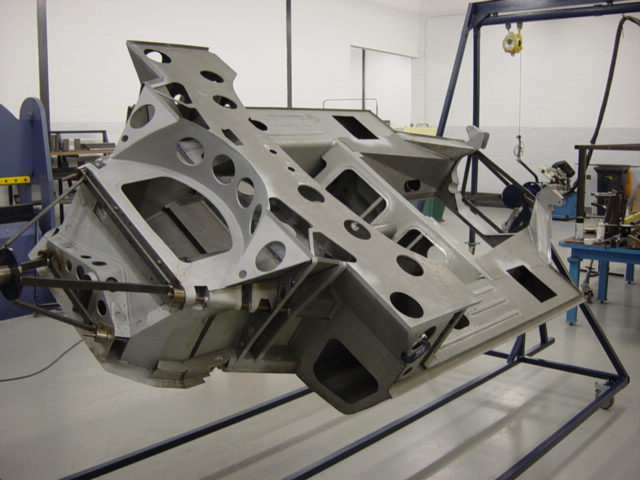

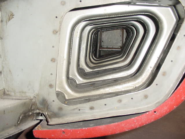

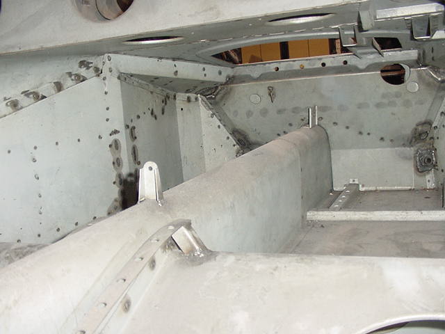

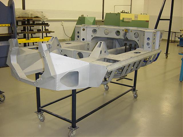

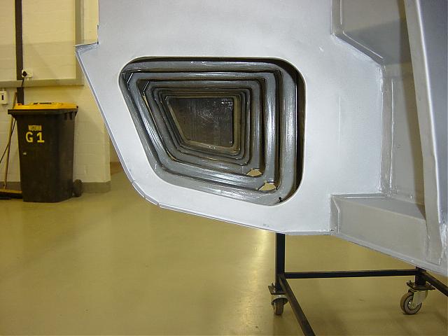

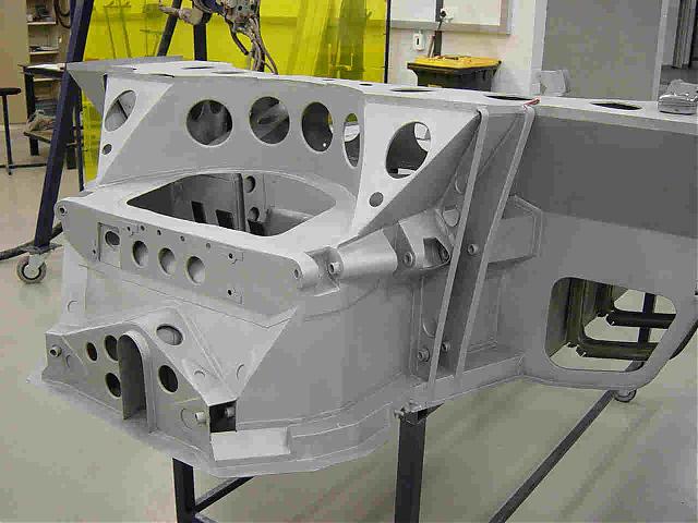

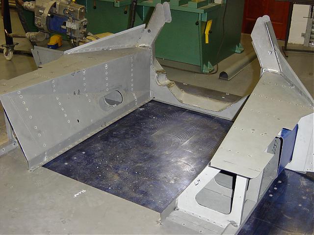

Re: Open letter to Jim Price of Hi-Tech
some chassis pics
ID:	25330   Click image for larger version
Name:	ASS INNER REAR VIEW.jpg
ID:	25331   Click image for larger version
ID:	25332   Click image for larger version
ID:	25333   Click image for larger version

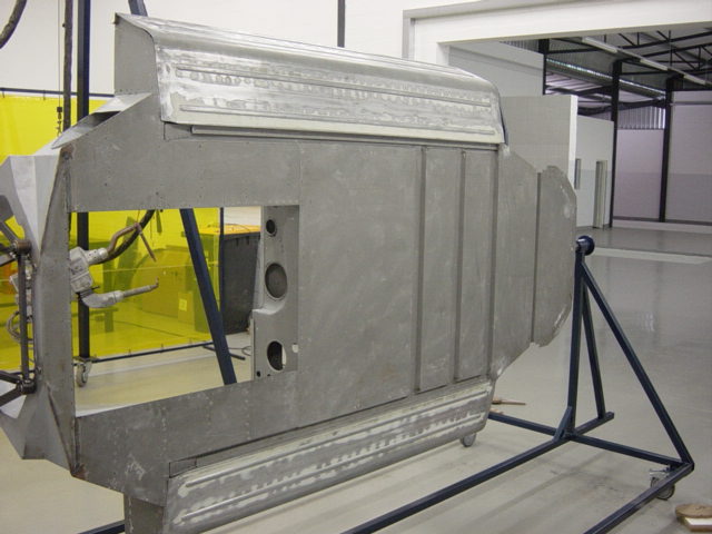

some more SPF chassis pics
ID:	25340   Click image for larger version
ID:	25341   Click image for larger version
ID:	25342   Click image for larger version
ID:	25343   Click image for larger version

Thanks Chris, great pictures hope you didn't have to kill anyone for them. Looks like I have way more work to do than I thought. There is one shot that almost shows the structure of the frame around the tube that the lower control arm runs throght. Guess I’ll drill a hole at the rear (just in front of the rear tire) and see how far forward I can see. Like I said in the post I really don’t want to play proctologist. Do all the ribs (not sure what else to call them) have holes through them the same shape as the outside perimeter of the part? Now if I could only get my halo deck fixed I could just walk around the part and have a look, lol. I’ll post pictures as I go. Might still need that endoscope.

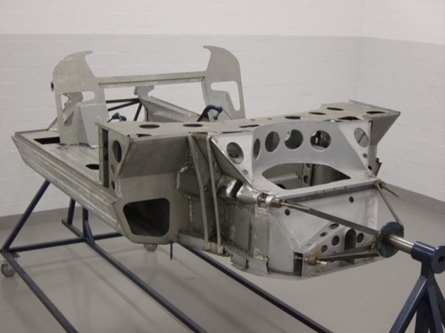

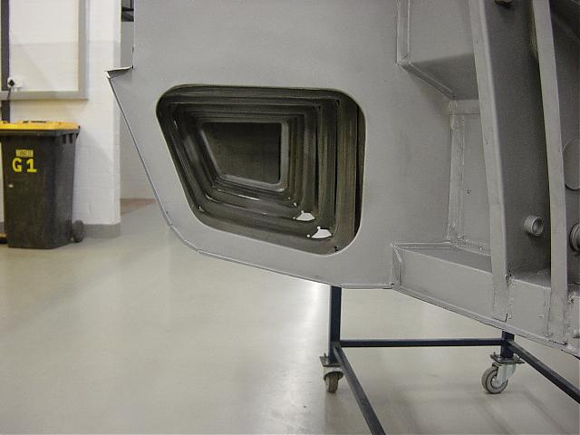

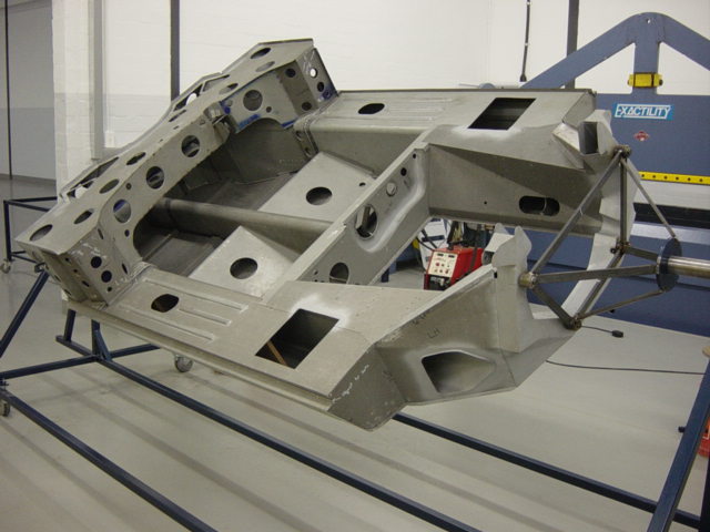

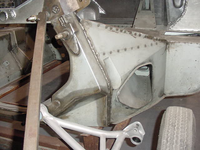

Some original chassis pics
ID:	25348   Click image for larger version
ID:	25349   Click image for larger version
ID:	25350   Click image for larger version
ID:	25351   Click image for larger version

Chris, Thank you for posting the pictures. Those were all of chassis #1. As you can see all the panelling is automotive grade "zintec". Before etchcoating and painting we also seamseal all joins. I also agree with Roy that the original bag tanks were a cause of most of the sill rusting. Our stainless tanks allow plenty of ventilation space inside the sills as well.I very much doubt that, with the type of use our customers put their cars to, corrosion will ever be a problem. That said, any extra protection cannot hurt.
kind regards Jim Price
