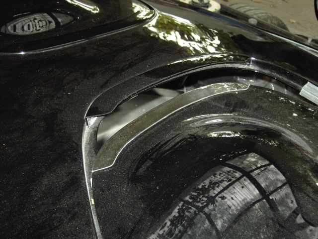

The button idea for the top of the doors where they go under the eyebrows is ok for a short time but I didn't think they would be a long term solution as they put too much pressure on a small area on the eyebrows and cause wear grooves in a relatively short period of time.
I opted to make a stainless moulding as per the photo which spreads the wear over the whole eyebrow and also due to the thickness of the stainless and the method of fixing (Sikaflex) it gives thickness which pushes the doortop down onto the rubber seal.
When the door is closed nothing can be seen and when the door is open it looks much more professional and finished.

Is your moulding flat or does it have an L shaped edge; does it need to return over the edge of the door to prevent the eyebrow from catching on the foreword edge of the moulding?
Nice idea by the way.

Yes it does fold over the edge.
I made a wooden former and hand moulded the stainless over that so that it would be held on and finish the edge and to prevent it being caught by the eyebrow and to avoid the sharp edge.
