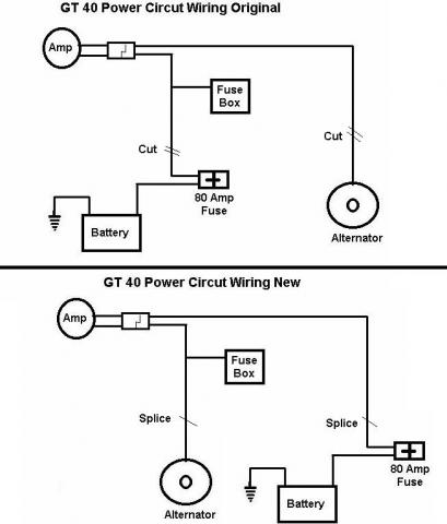

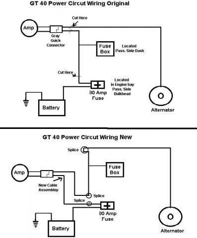

I posted a "How To" a few months back on how to install a voltmeter in place of the SPF ammeter. I agree that a voltmeter is better than an ammeter for telling you what is actually going on in the charging circuit. However, for the guys that want to stay with the ammeter, below are diagrams on how the wiring should be done to fix the problems with the SPF cars. The problem stems from the fact that the factory wires the ammeter such that it is placed on the wrong side of the load in the system. What complicates it even further is that some cars have this problem while others do not. It seems to be a quality control issue to me. Be that as it may be, here's how to fix it or change to a volt meter.
You will notice that there are two version of the fix, one from Cantor (the harness manufacturer) and one from Dennis Olthoff. I personally like the Cantor version better but either will work.
Well, somehow I missed that! Thanks very much for documenting that. I did call Dennis and though he was out, I was informed that there were a few cars the same as mine and there was a fix.
So, I have the method, now I just need to implement!

As an update... I implemented the easy fix on the ammeter wiring.
I cut the wires and swapped them back near the large 80 amp fuse block.
With the key on, the ammeter then read backwards and I had to swap the wires on the ammeter. Everything worked, but then I found out why I always seemed to have a low battery....
With fans on, it would charge, but not much. With the A/C on, next to no charge. With the fans, A/C and lights on... big time discharge.
I could never see this before as the ammeter was reading total system current.
So I put a new 130 amp alternator on and everything is fine.
