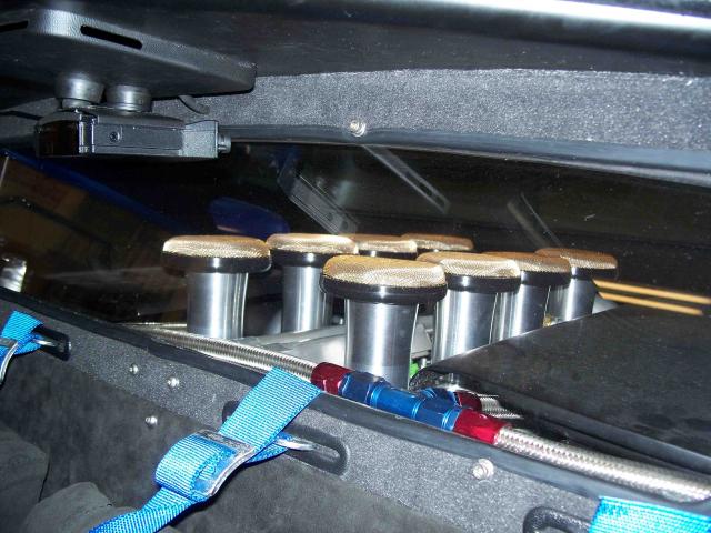

Here is the solution my brother Alan came up with when faced with finding a permanent mount for a Valentine One radar detector in P/2192. I wanted the detector fixed with optimum 'vision' forward and to the rear; at the same time, I wanted all of the controls to be near the dash and all lights and sound alerts to be remote from the detector itself.
As you can see from in the first photo below, he affixed it to the vent box located to the rear of the passenger compartment. In order to get the best exposure to hostile radar or laser, he attached the detector unit to some rubber bushings, which lowered the antennae below ceiling and aft deck lid obstructions.

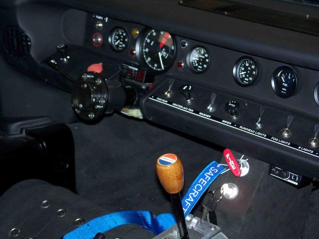

The second photo shows how the V1's controls are arranged such that the visual light indicator (that shows the direction of the radar/laser) is mounted atop the steering column directly in front of and below the driver's natural field of vision. The audio controls had to be placed below the dash towards the passenger's seat to avoid being jarred by the driver's knee.

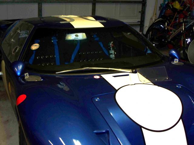

Here is the offset mirror. Also note the closer-to-original stainless steel wiper arm assembly that replaced the all-black SPF unit.

Great work on the Radar Detector! That's how I'll probably rig mine up. Where did you get the wiper arm?

love your engine setup with the 8 stacks....im looking towards doing something like that myself.
