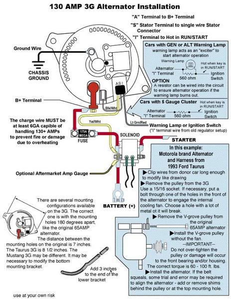

Here's how I did mine, works great and I did buy the plug from Ford as suggested earlier. One strong word of advice, BE SURE TO INSTALL THE FUSE! The vendor where I got the alternator told me not to put the system at risk without it.
Good point. The SPF harness runs the Alt output wire forward all the way from the Alt along the RHS sponson, over to the ammeter and then back through the RHS sponson before it finally gets to an 80A fuse. So a fuse right near (or on) the alternator would definitely be a good idea. To be even safer replace the ammeter with a voltmeter, and eliminate about 12 feet of high-current wire.

To start, I had found the same diagram that VEEK had posted, and planned on adapting it to the SPF after reviewing the SPF schematics.
If you look, you’ll see that the blue “warning light” wire and the black “ignition” wire are both part of the same circuit, and come on with the turn of the ignition key. I tried using one, the other, and then both as the “exciter”, but settled on just using the blue wire. It gives me power to the regulator when I need it (on with the key), and when the car is in the run position with the engine not running (or when the alternator not working), the warning light glows. The light turns off when the engine starts (if the alternator is functioning). That’s what I wanted.
The downside is two-fold. First, if the dash light burns out, your alternator will not produce power. Second, from what I’ve read, you could potentially run your battery down or kill your regulator if you left the key in the run position for a long time without the engine running. An alternative is to use the black “ignition” wire. This bypasses the dash light, but doesn’t eliminate the other potential problems. VEEK’s diagram suggests using a diode to eliminate these last two problems, and if wired correctly, could be used on either circuit.
The actual install is easy. Just follow the diagram.
1. Spice blue “warning light” wire to wire coming from “I”.
2. Put a female spade terminal on the wire coming from “S”, and slide it on the male spade on the side of the alternator.
3. Put a ring terminal on the wire coming from “A”, and double it up on the lug to which the large battery cable attaches to the alternator.
Note the suggestions re adding a mega fuse, and eliminating the ammeter. I’ve ordered a voltmeter, but they are stuck in customs for now. Something about importing parts that look like bomb-making materials.
I have part numbers for those who want them, but really you’ll just need to match the wire harness to the regulator on your alternator. Cost me $30 for the harness. You could do it on the cheap with spade terminals, but why do that on a 6 figure car?
If anyone has any suggestions, I’d love to hear them. If my car burns to the ground because of this, I’ll be sure to warn you.
Way to go!
The only perfectionist comment I would make is that the A wire is the alternator's sense lead and will do a better job of charging the battery if you move it closer to the battery + terminal. That's why the diagram has it on the starter solenoid and after the fuse. This allows the fuse to present some resistance and still fully charge the battery; the ammeter basically does whatever it has to to get the A terminal to the desired voltage. That also means you (as a car designer) can back down a little on the size of heavy cable between wherever A is and the alternator, since the alternator will make up for any voltage drop in the cable (up to a point). But all this really means is that your alternator will act more like a one-wire (although with an indicator output). More of an abstract point than a practical one, and not something worth expending any concern or effort over.
And as another academic point: I think you didn't have to use the black wire because the jumper on S took care of supplying the stator. Somebody who knows better please correct me.
