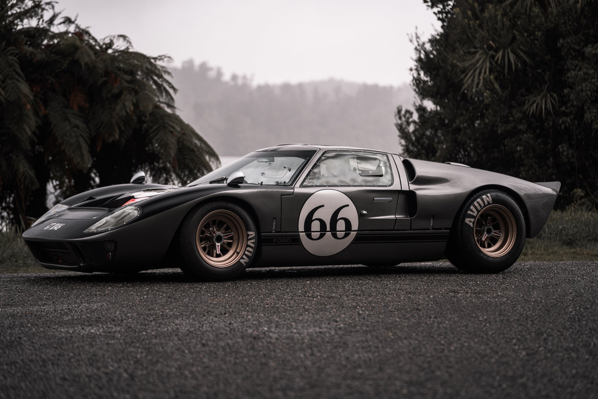

Brian Stewart
Why not go with Avons (while you still can)? My car is used exactly as you intend to use yours (i.e. mainly street use with the very occasional track day) and the Avons have been superb. In fact I have another set sitting in the basement ready to be put on in another 200 miles or so. Only drawback was having to paint the lettering on myself.

Mike Pass
The Avon cr6zz tyres are exactly what you need. They are pricey but excellent. I have been using them on my GTD for 15 years I use 215/60 x 15 front on 8" wheels and 275/55 x 15 rear on 10" wheels. Mostly road use with occasional track use - perfect for both. Everybody I know uses them on 15" wheels.
