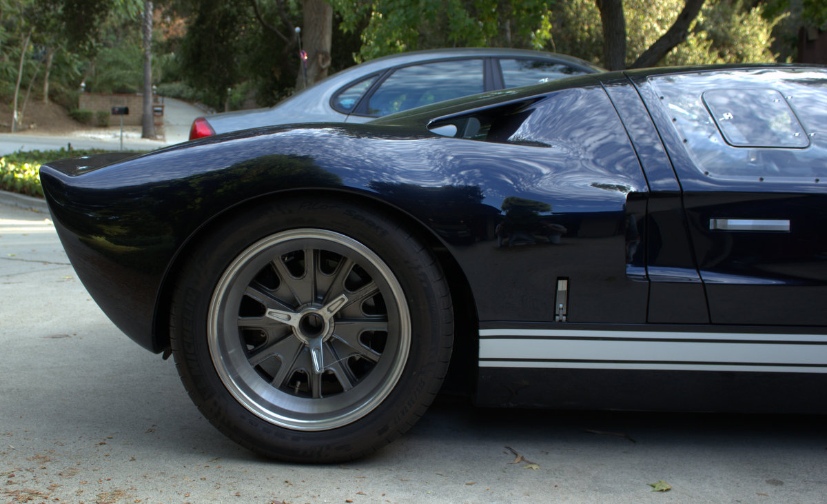

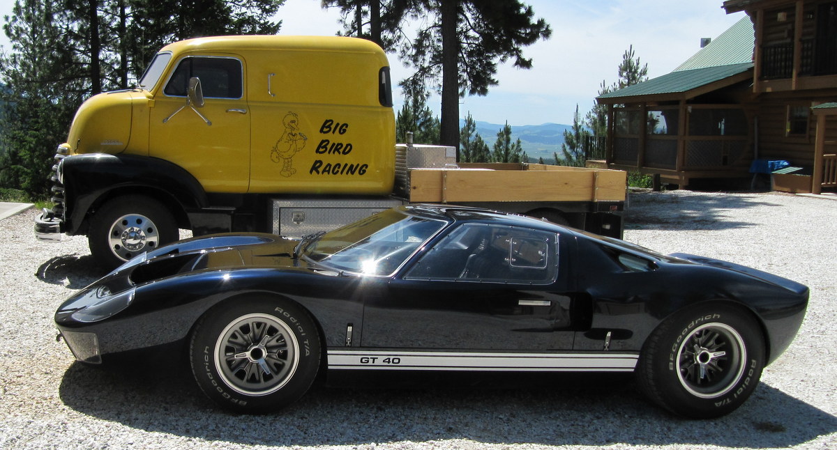

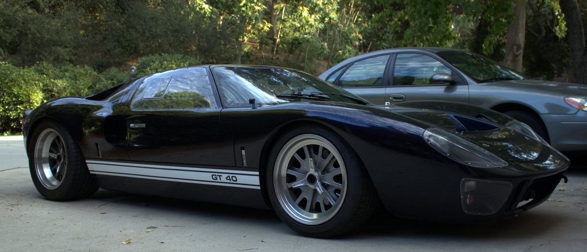

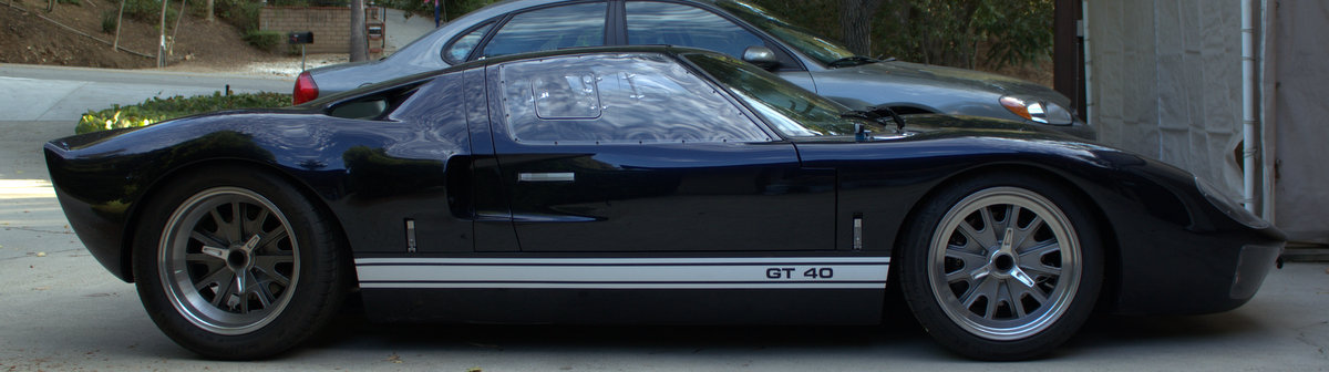

I'll let you decide which one you like best. The 17" wheels are good but don't match the looks of the original wheels like the 15"s do. I like the 15"s much better but it is hard to find good tires.

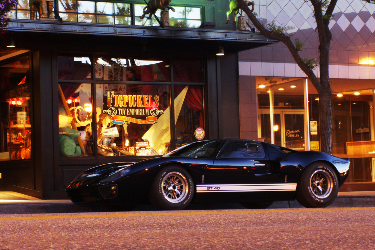

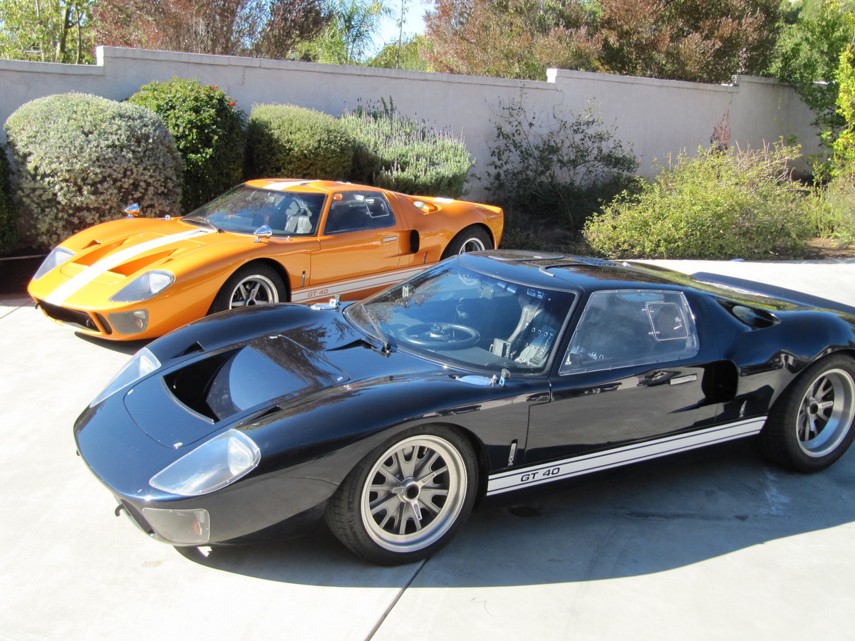

does not look bad, 17" on the back looks very good, on the front a max 16" would look a bit better perhaps.
made them together>>
would be nice if the fronts could be 16 inch when the rears are 17 inch me thinks.

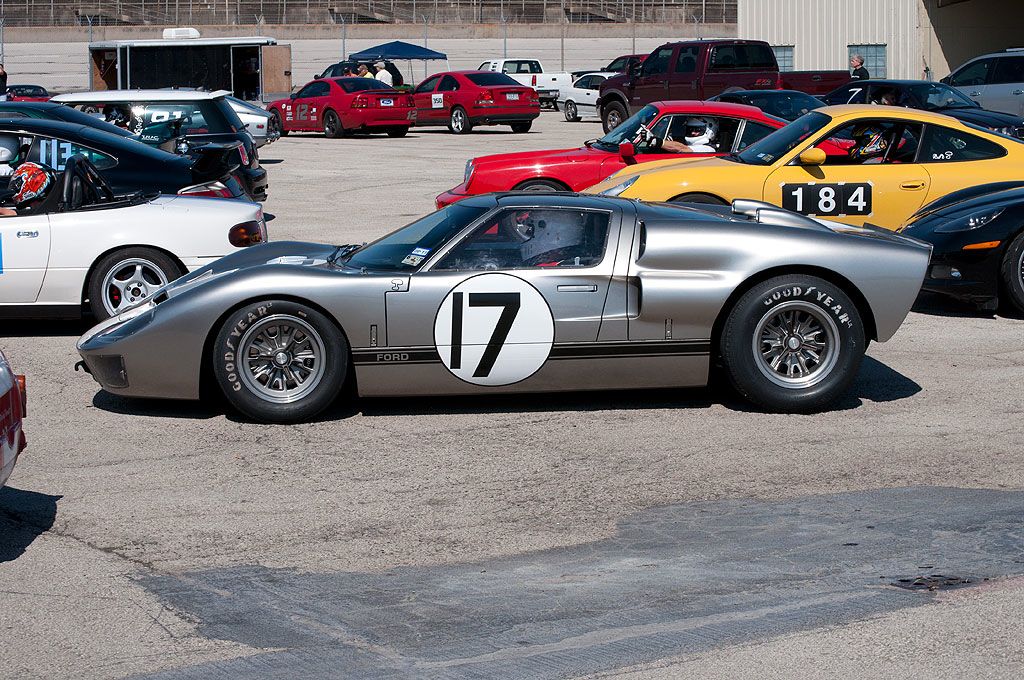

Kirby Schrader
They're mostly silver
Kirby, what size and model Goodyears do you use on the track? How long do they last?
They are Goodyear Blue Streak Sports Car Specials
6.00 x 15 fronts
8.00 x 15 rears
They are very sticky and pick up pebbles big time. I think they'd last three weekend sessions or so. I haven't beat them up that much yet and they're probably getting old now... I haven't been to the track since January and then I drove there on the Michelins.

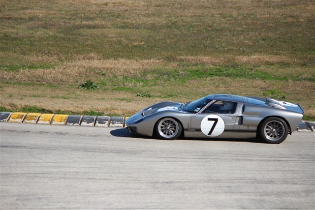

Here's a picture of the 15" on the car with the original 15" wheels and another picture of the car with the 17" wheels and Michelins.
Sorry for the late reply. Been busy!
Kirby
