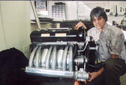

He also owns a unique piece of Mercedes-Benz history. In 1956 Paul O'Shea persuaded Daimler-Benz to prepare two lightweight 300SL Roadsters for US Class D racing. Bodies were of aluminium and four spare engines, with aluminium blocks were prepared. The inlet manifolds were of welded aluminium sheet.
Somehow in later years, a medical doctor in Johannesburg, who raced powerboats managed to get hold of one of these extremely rare engines for his boat. Malcolm now owns the engine of which pic follows.

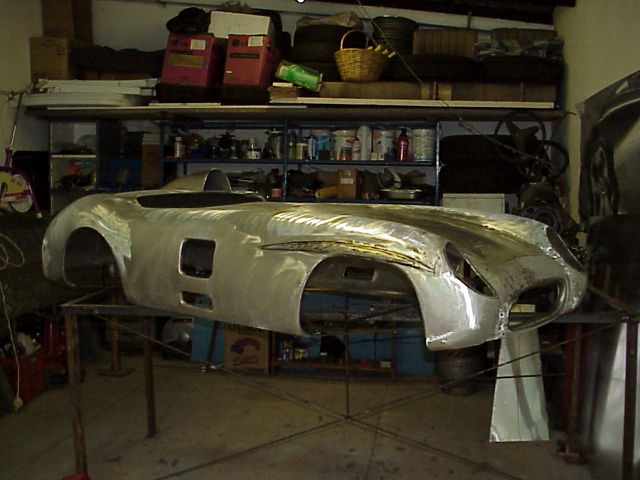

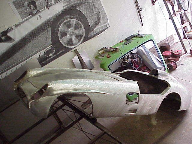

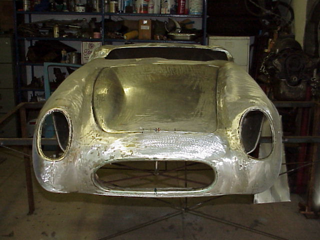

When I offered Malcolm the 300SLR project he grabbed it with both hands. He also had a Burago model which he had digitised by the CSIR (South African Council for Scientific and Industrial Research) over 3 000 points. From the print outs the body profiles were made and then an aluminium body. Visually the car will be so exact that in a photo it would be difficult to tell it apart from the original car. Stirling insists that the steering wheel must be a four spoker as per the original. All the W196 GP cars and other 300SLRs had three spoke wheels but as Stirling preferred four spokes Mercedes race boss, Alfred Neubauer, had the wheel specially made up for him. Today it hangs in his study. Engine will be from a Yamaha Quad bike which makes sense as it has all the electrics attached. Malcolm wisely came up with the idea of a two thirds scale for not only will bigger kids fit in but Mini tyres at 10 ins are virtually to scale to the original 16 ins wheels. The pics below show only one head fairing but the production models will have two with Union Jacks on the sides as per the original. As Fangio drove alone in no: 658 his car only had one head fairing
As the aluminium bodies will take a long time to shape production of the baby 300SLR will be very limited. Malcolm is still figuring out how many he would be able to build in a year.
See attached pics.
