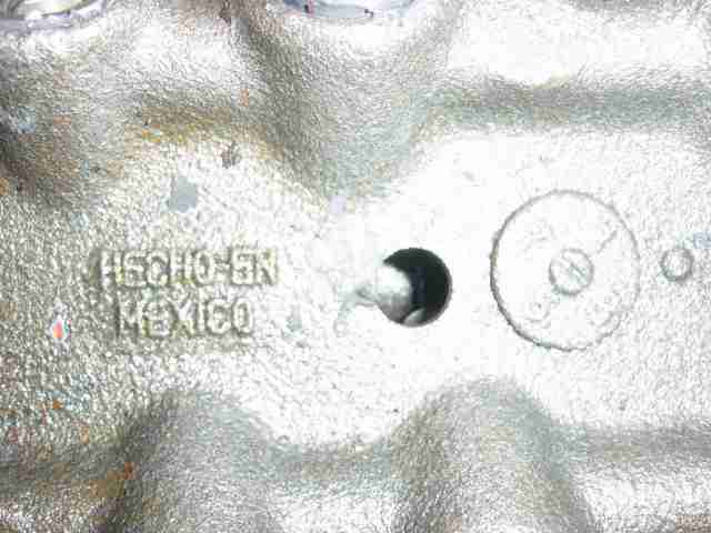

Mexican blocks can be identified by casting numbers C8AM-B, 75ZY-AA, D1ZM-AA, among others, these blocks may be spotted by the "Hecho En Mexico" cast in the lifter valley.

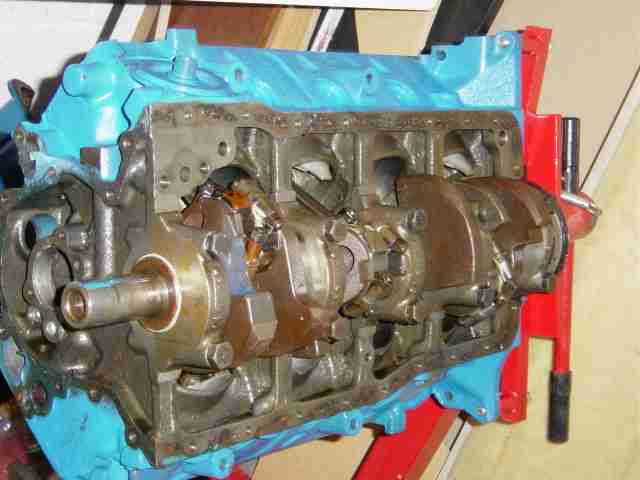

might look a bit like this
Yep,these are the mexican blocks.I bought one lately and is in overhaul.
My block number has an Z wich means it comes from a Mustang and is from 1971.

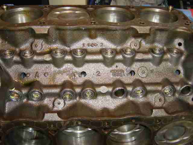

Brett, That's it! Do you have a pic of the front of the block that would show the humps that are unique to the M-block? (Sorry, but I don't have a digital camera)
Thanks Brett,
I think that is great tech for anyone that may not be familliar with the hump (it's on both sides). It's very easy to spot one.
