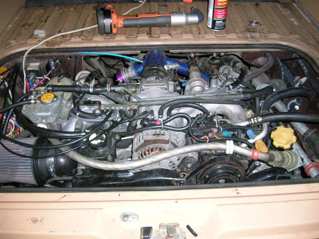

Ok I may have went a little overboard on the HP so I dropped the boost level down to 7 psi from 15 psi. The second time I got on it to check the A/F ratio on the gauge I heard a popping noise coming from the back. It was in tune with the wheel speed so I dropped the old CV joints down and yes they didn't like the punishment. So I have new half shafts on the way and will keep the boost level down to save the input shat and transaxle of the the old VW Vanagon. I put a clutch and pressure plate in that is good for 300+ HP so from that back is going to be a good question. When you got on it and boost came up I had a hard time controlling the old girl as she has never been 80+ MPH that I can remember and the front end comes up so high that its hard to steer, the subie engine is heavier and the extra power really exaggerates the steering so I put new shocks all the way around and airbags on the rear coils, also the subie had pwr steering pump cruise control, and AC so I added all of them which makes a real joy to drive. I have several people ask me "WHY?" well two reasons, ONE is the long block 105 HP VW waterbox is $2500 with a core, the JDM engine I got had less than 40k miles on it and twice the technology for $960 all day long. The adapter bell housing is a perfect unit made by a company in WA www.smallcar.com for $590 which included the internal hydraulic throw out bearing. I will hand it to these guys what they sell is perfect engineered stuff, it fit like a glove and great instructions on how to do it. The subie conversion is quite popular because of cost and reliability. Doing the twin turbo is a little overboard, I think the standard subie engine is what most guys do and a good swap.
The JDM Subaru twin turbo WRX motor stock is 250 HP at 10 PSI water to air intercooling, so at 7 PSI and water injection it should be in the 200 range and some easy foot feed it should last many years to come. I opted for water injection because there is no room for an intercooler and there is a built in 20 gallon water tank in the Vanagon Camper. The motor mounts for the twin turbo were totally different that was Small Car sells so I had to make them myself and that was pretty easy done. The exhaust is two super traps I had used on my twin turbo Ferrari so I put them on which give its a real cool sound, the twin turbo subie engine is sequential so only one side makes noise till 5 PSI of boost then the second side opens up, the subie engineers really had this figured out.
TWO Because I love doing it and I can.
The real test will be the Rocky's in two weeks when I drive her back to CA for a family visit. I will post some more pictures when she is all done.
PS if anyone wants a long block 1.9 waterbox for a Vanagon with new heads real cheap let me know, it on a pallet and ready with all the hardware.
