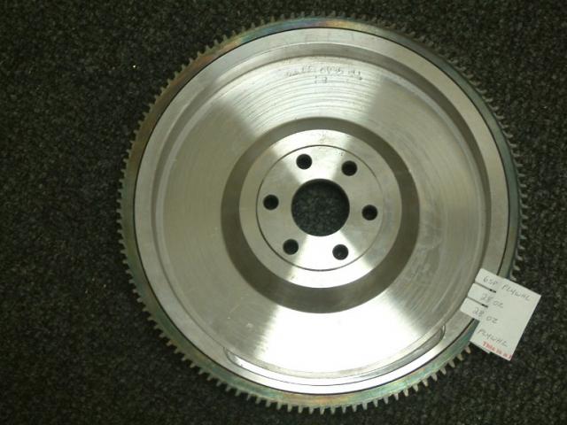

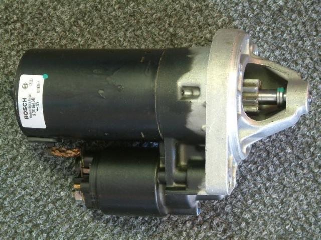

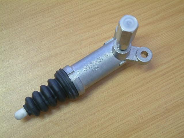

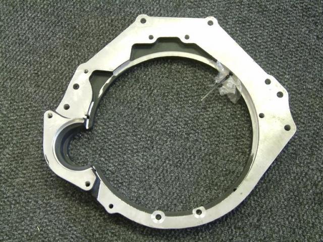

Contact CAV South Africa.
They do have a complete kit for a Audi to S/B Ford. It includes adapter plate, flywheel, clutch plate and p/plate, clutch slave cyl, starter and gearbox mountings.

KEP in California USA makes this adaptor. I bought one of the first ones they did and they have them listed in their catalog.

Quick thing you actually haven't said is which type of Audi.
If its an 016 than KEP will work just fine.
If its an 01E/X then you will need to get someone like Helix to make a new friction plate for you. Don't know if the CAV is for 016 oe 01E.
I modified my KEP to work
Also, I know that Fran also does an 01E to 302 kit.

PS make sure you have a slave cylinder that you canconnect to!!
