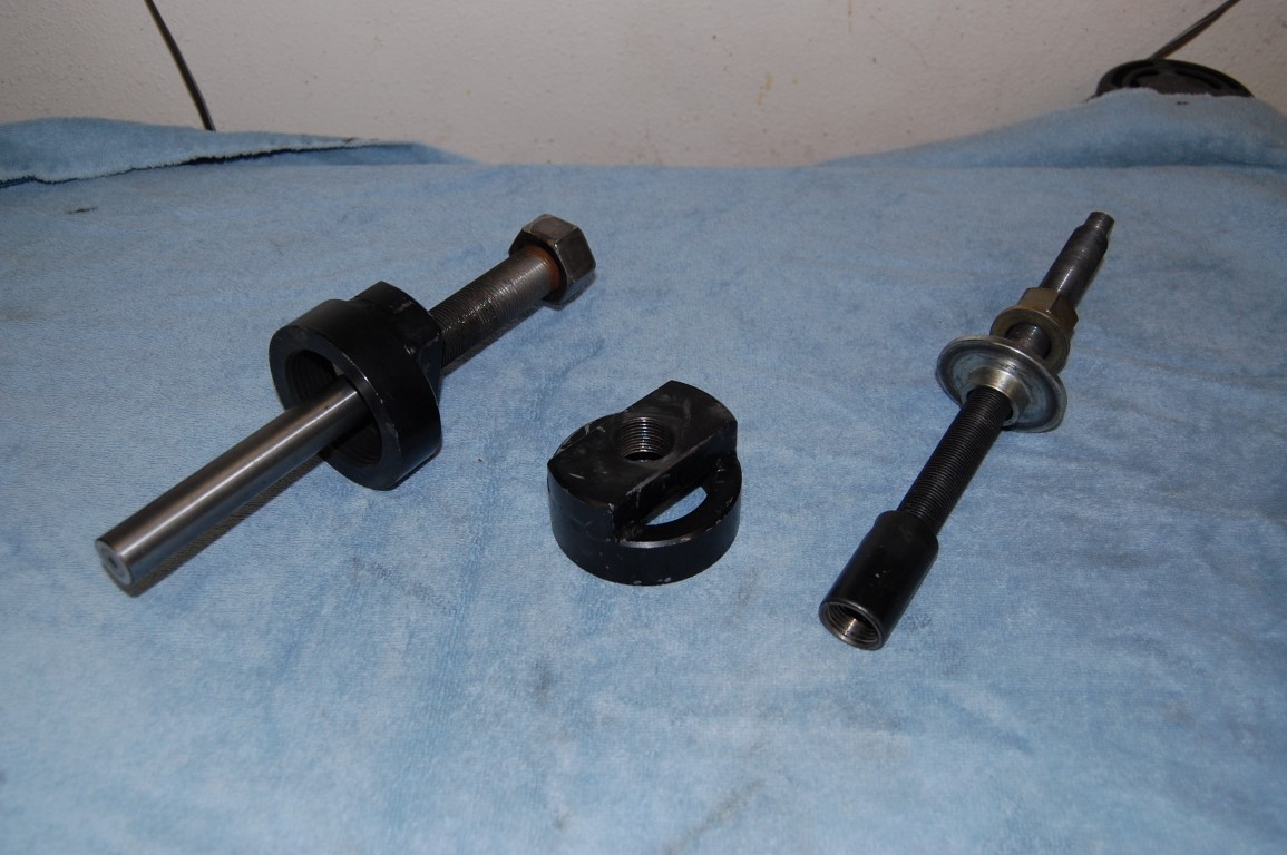

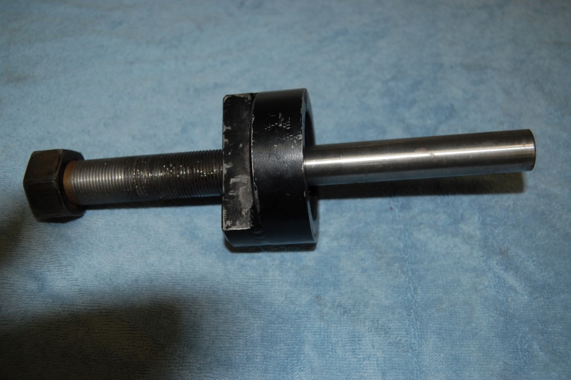

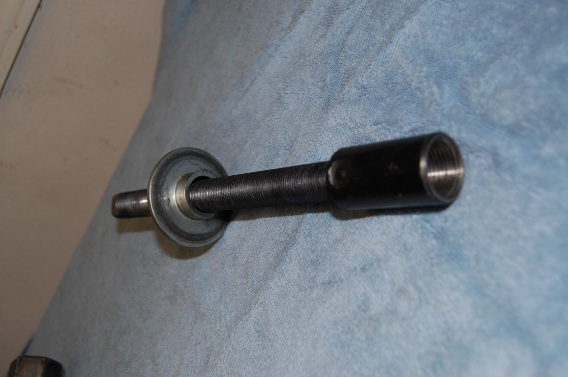

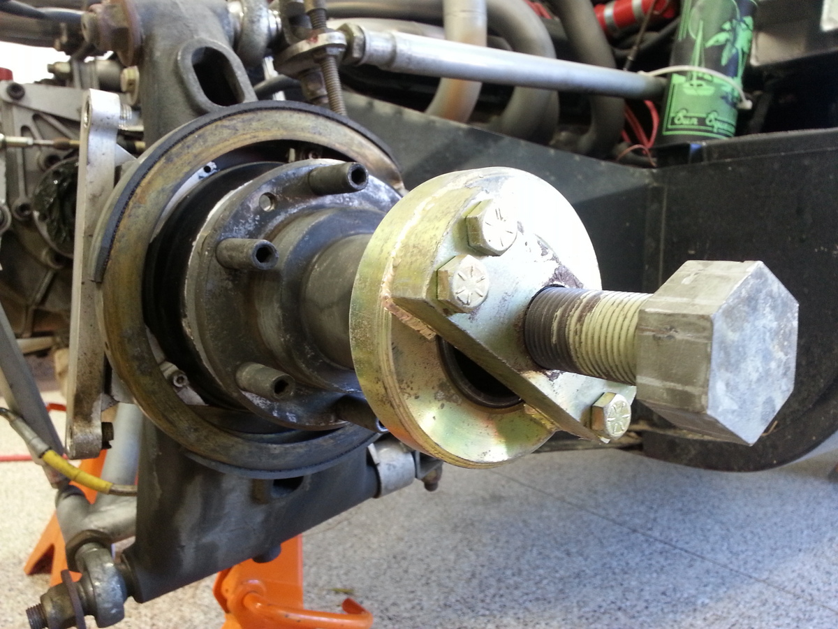

Also attached are photos of the removal and installation tool. The tool with large black object threads on the hub and then is used to push the inner axle inward for removal. 2 black parts are needed since there are right and left handed threads on the hubs. The other tool threads on the inner axle and pulls it outward for installation.
I sent you a PM regarding borrowing my tool.

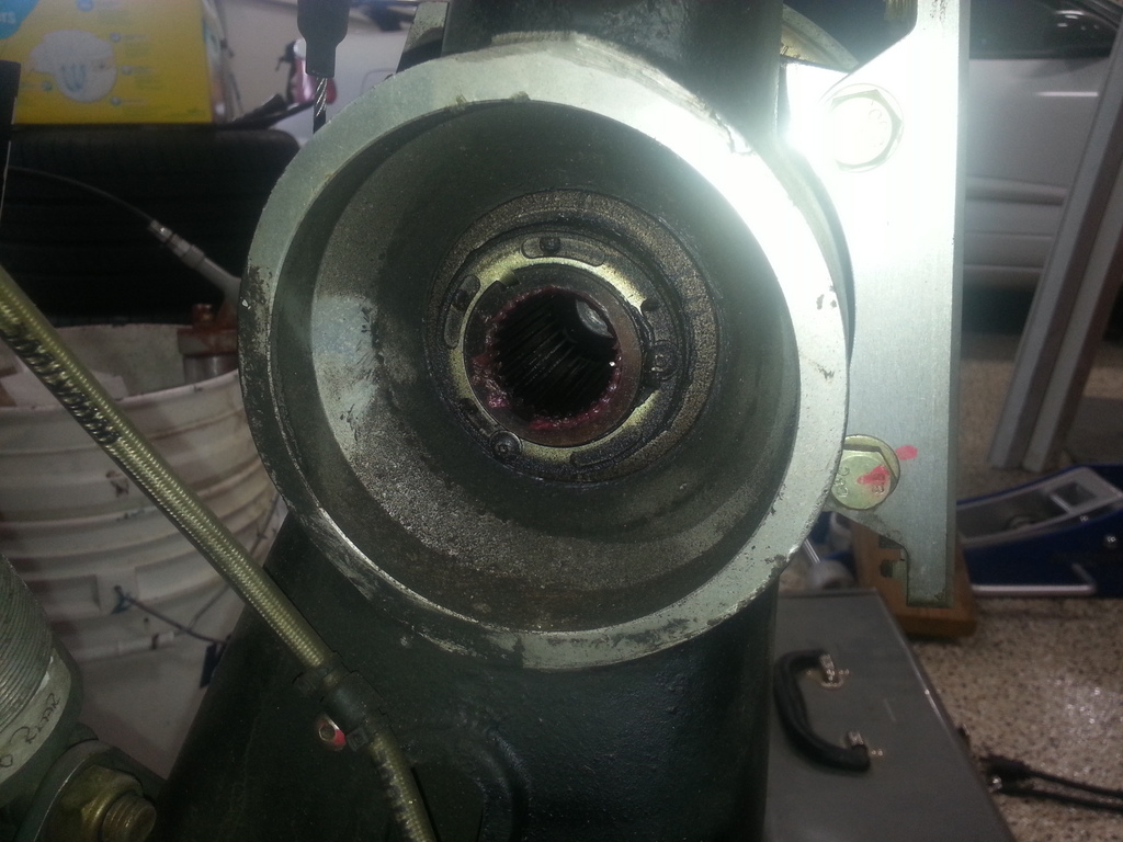

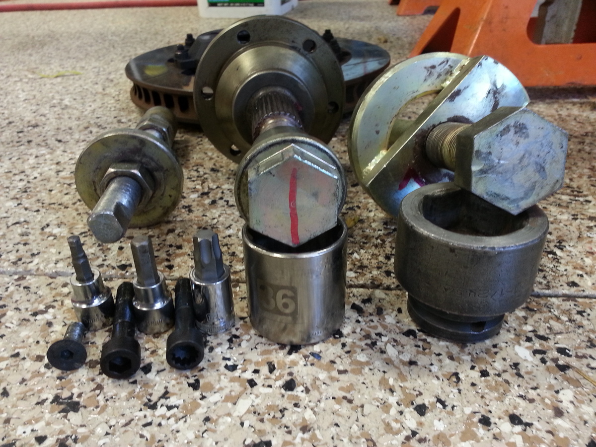

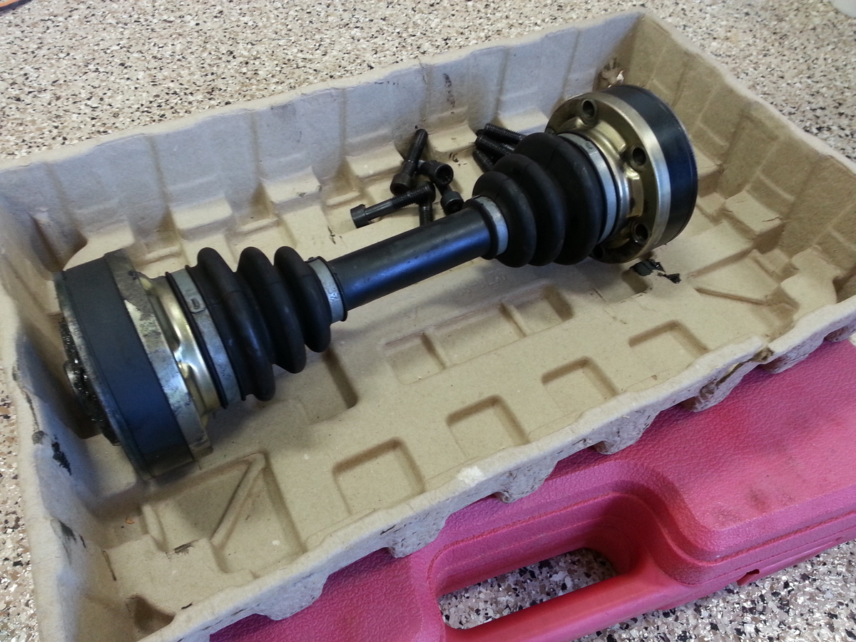

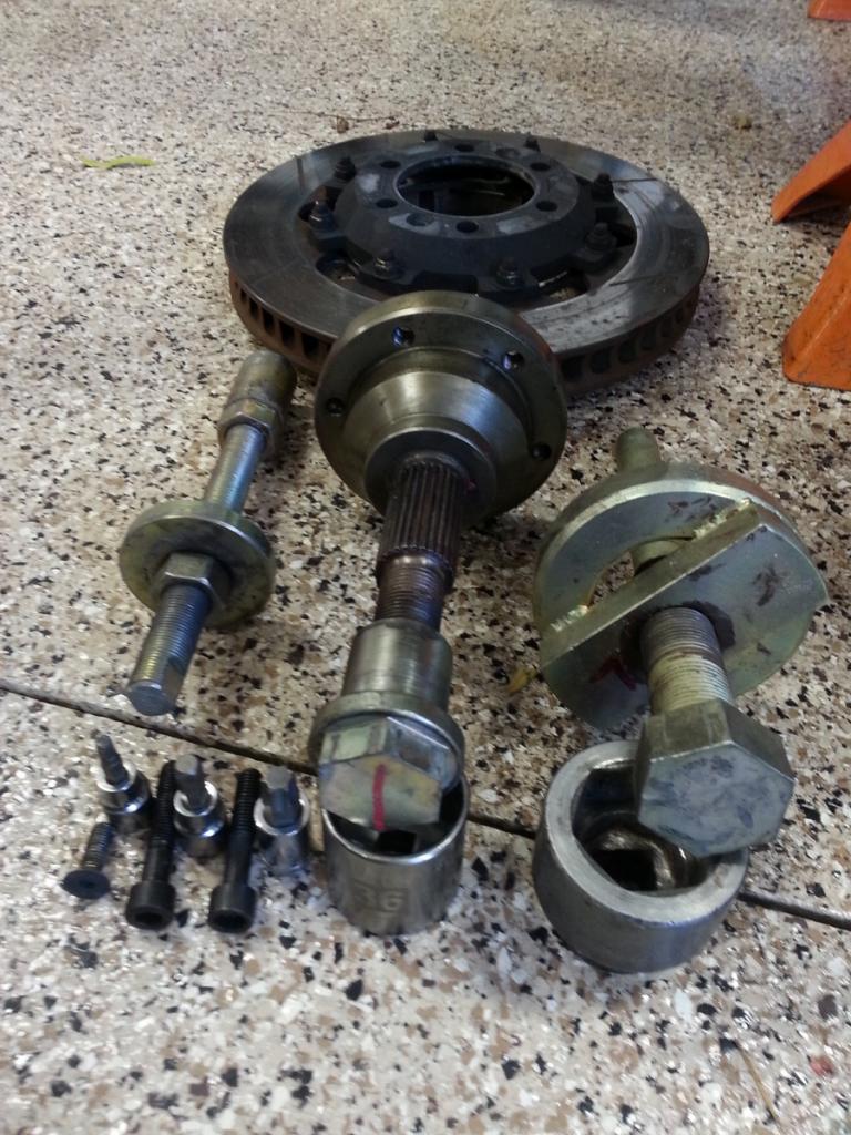

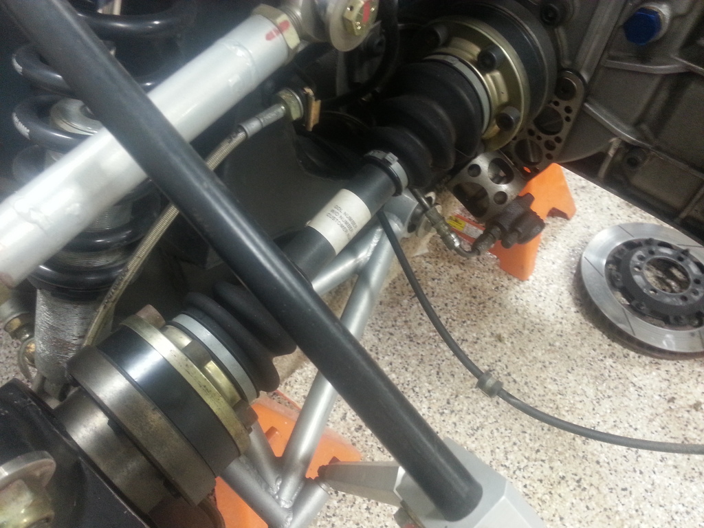

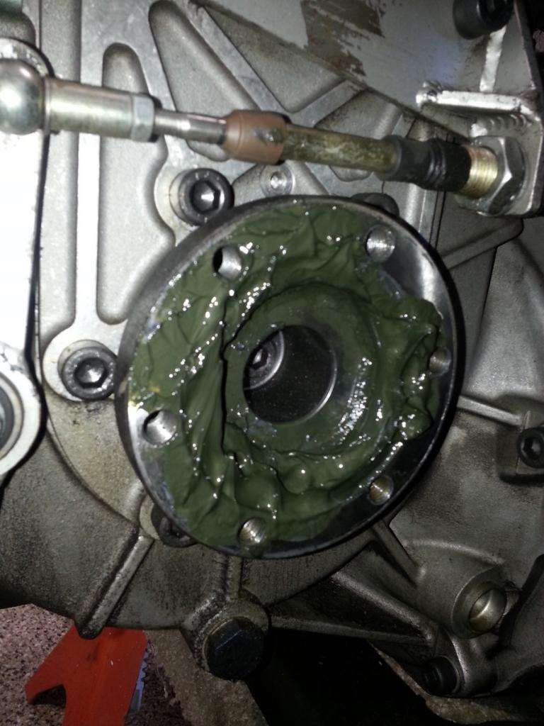

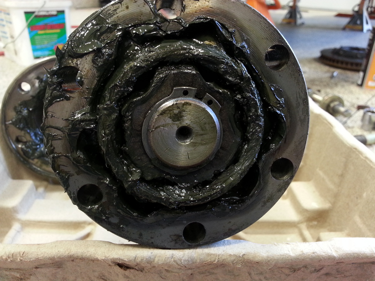

I just so happen to have my 40 apart so I thought I would share some pictures which may clear things up.
You just have to remove the 6 bolts at each end of the axle to remove it. On my car that took an 8 mm allen at one end and a 55 mm torx at the other. Go figure as they look to be the same size. To service the CV joint it looks like you'll have to start by removing the snap ring. As I haven't had the pleasure you're on your own. Looks really messy.
If like me you do need to pull the stub axles to adjust pre-load or replace the bearing you may need the special tools. I've tried many pullers but nothing worked until I got the real thing. Even then I broke one of them and had to put bolts in to repair it. Mine were in that tight. I hope SPF has fixed that problem. The tools are not cheap at around $400.
To remove the stub you first have to remove the 36 mm nut that hold the axle in place then push it out. Be careful like I said I tried many different approaches to remove the axle before getting the right tools. At first I borrowed a set of tools but then had to buy the kind gentleman a new set when I broke his. It ended up OK because I really needed a set of my own.
Just be warned there is a lot of very expensive parts that could take a long time to get back there so don't go beating on things. I've been lucky so far.
So I hope that helps. If you need more pictures or info just let me know. It has helped that I did my own install so I've seen most of this stuff before.

John I looked into making the tools and had to give up. I thought if I could find the right size nuts I would be in, no joy. I wasn't able to find the correct left hand threaded nut. Maybe if you could find modern nut type equivalent to the wing nuts. I'm sure they would be very expensive. Then you would have to bolt on a threaded cross piece then find a big ass bolt to do the pushing. Then there is the matter of the installation tool. I'm sure the tools I have were hardened after they were made. They are really tough. IMHO there are worth every penny I just wish none of us needed them.
If your stub axles are as hard to remove as mine are do yourself a favor and just buy the tools. You never know when you might need them and you don't want to be without them. Because I've done a lot of long distance trips I keep mine under the drivers seat. Maybe if you have someone else in the area you could share but I wouldn't recommend it. My friend Lynn said his just slid out.
Sorry for the bad news. This is something that should have never happened. If I had to guess it boils down to manufacturing tolerances. With a big impact wrench I'm sure the guy on the line doesn't notice how tight the thing goes together.

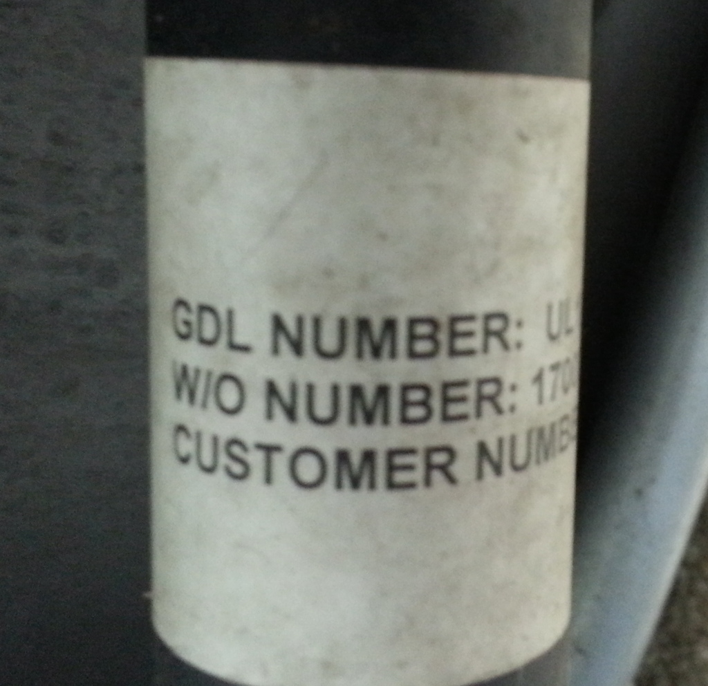

i was given info for cv boot as GKN Lebro. ok, fine and dandy but lots of GKN Lebro boots there. do you have part no. for boot? sure would narrow it down.

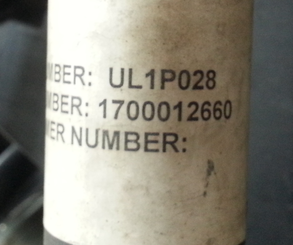

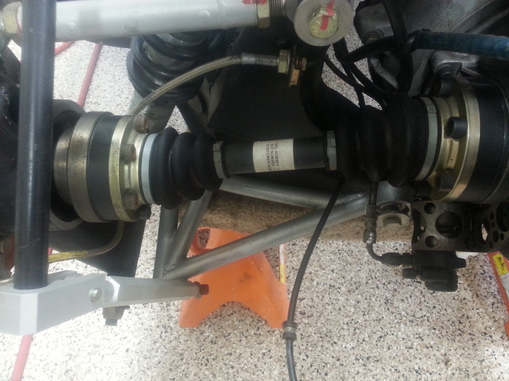

John not sure it will help but I found a tag on one of my axles.
