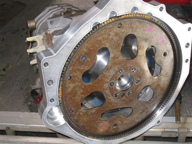

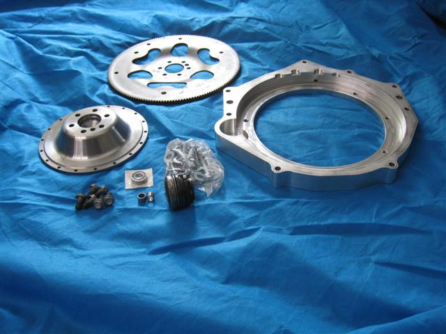

We use the standard starter and flex plate custom flywheel and 40mm thick adapter plate :----------

Wouldn't the usual suspect's (KEP for example) adapter plates work from any LS series motors? I understand the LS4 is slightly shorter on both ends of the crank, but a spacer of some sort may work to fix that. The Porsche boxes place the starter on the bellhousing as you've probably alread figured out.
