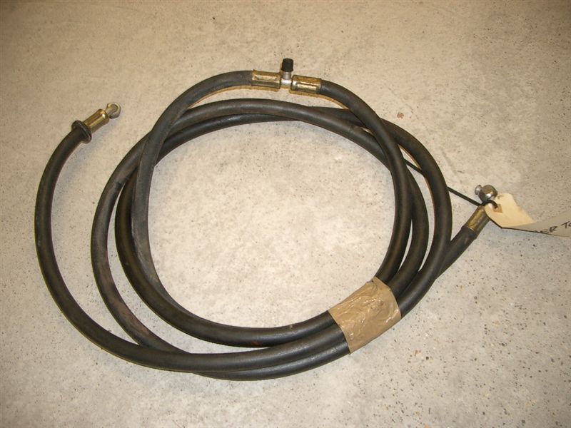

We couldn't find a fill valve either & I can't quite remember how we did it, but when I stripped the system out of the car I discovered a fill valve set midway in one of the hoses, so you may have to remove the sills and/or some engine bay panneling to find it! (assuming your setup is the same as mine!)
Sorry this probably isn't much help to you, but if required I can photograph the piping as it came off the car.
Simon,
Here is a picture of the hose with the fill valve. this hose ran from the the compressor to the condensor in the dash & so in my case the valve was hidden in the sill behind a fuel tank!
From memory, my system was re-filled at the compressor, but access was still difficult. If a bit more thought had gone into the intsallation, the AC would be alot easier to service!
