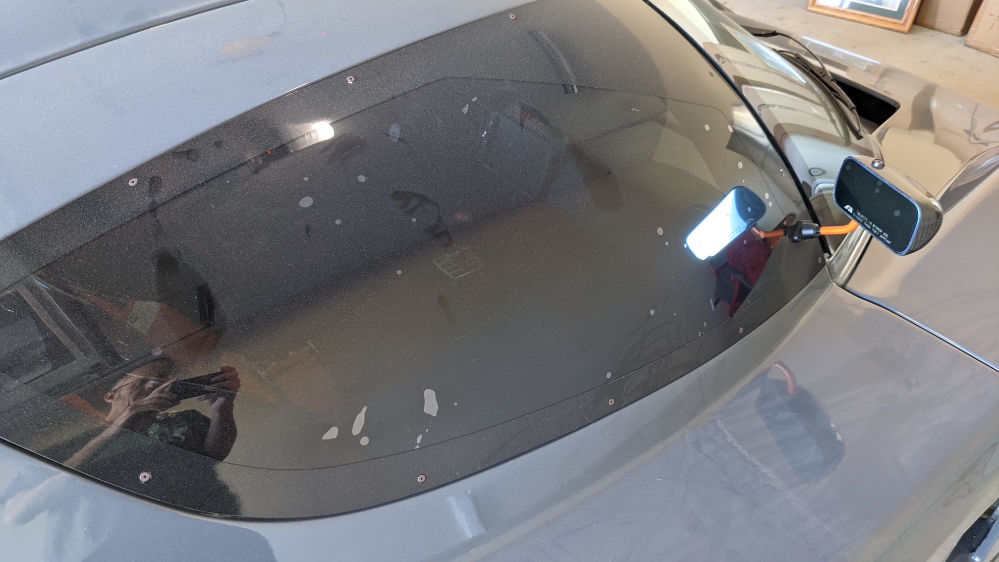

Since I've been driving mine more this year than last, my tint bubbles has GREATLY increase. To the point where it is getting embarrassing to even look at. I'll snap some pics to share on here or my thread, but definitely in same boat as you about removing it.

Here's my tint as of last Friday for anyone curious. Wasn't near this bad the week before, only passenger side was worse. I've considered hitting up place I got it done, he said they stood behind their work 100%. But I'd rather new tinted lexan if I could.
