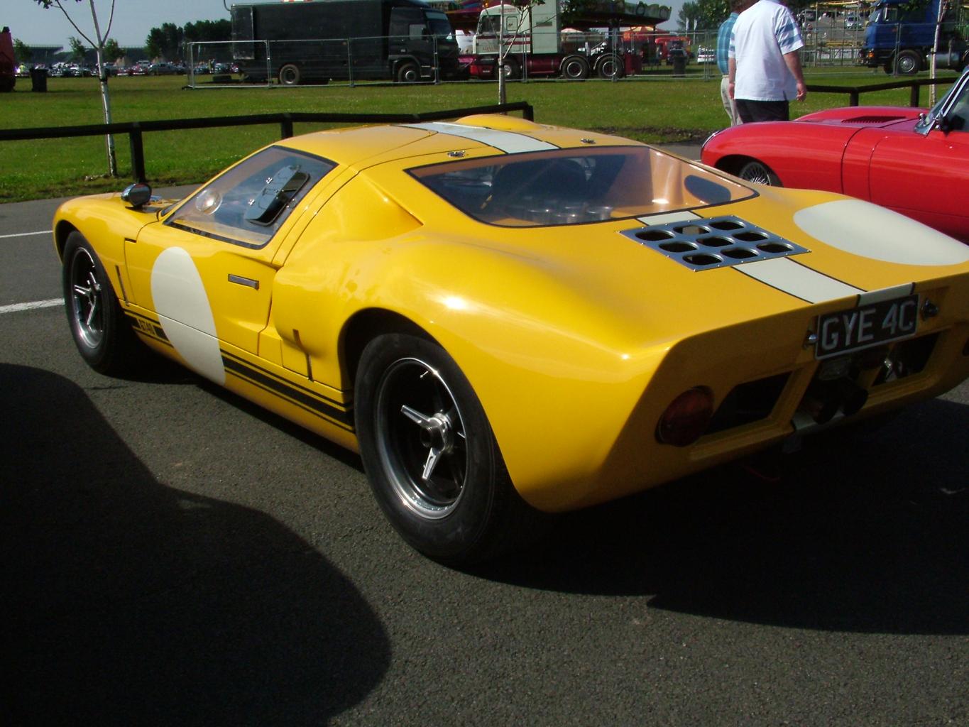

I have seen a 40 fitted with what I seem to remember were shaped pieces of fuel cell foam inset in the intakes. Not sure how it was secured, possibly double sided tape. Was not at all obtrusive. The car belongs to Chris Notley, unsure of the last time he posted on here.
