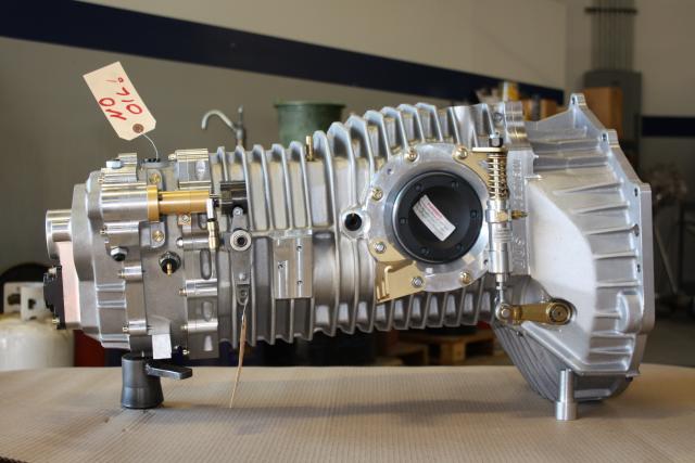

Incredible DeLynn - Please tell us more about that gearbox...

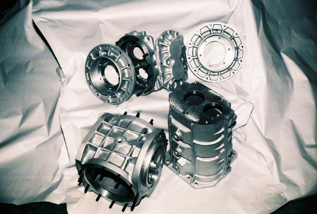

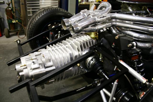

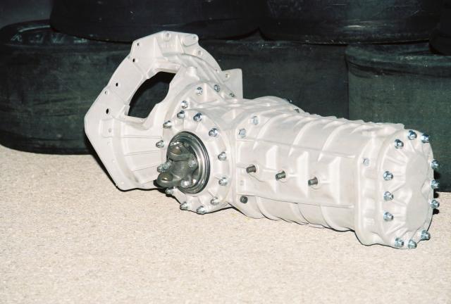

It was many moons ago,, 1990-1995
The Goal was to build and market a transaxle with off the shelf parts.
I thought it would be best to have the offest from crank to drive as close as possible. I used the transmission and case from the Nash/Richmond.. Installed a new tailhousing on the back of the transmission,, with room for QC gears..
The diff housing was also made to fit on the front of the transmission case..
I side it was a modified for 8" ring gear,, installed on a Dan Press Gold track carrier.
I made new input gear,, it would pass all the way thu the diff housing into the clutch..
The bell housing side was made to fit a Tilton 2 piece housing,, by leaving off the transmission adapter..
I had alot of hair when I started.... Lost alot of hair,, gained alot of knowledge
What more can I tell you..
You can tell us alot :D
You have been to the mountaintop my friend. I am fascinated and smitten with your design. Alas, I was still in high school when you stopped making the QC850, otherwise I would have purchased one by now!

That is way cool. U.S.A. made
Was the ring & pinion based on a spiral bevel or a hypoid gear?
How long was the gearbox tip to tail?
This is where we had are problem our gearbox was to long so we had to re- engineer it for the market it was intended.
Quote-"I had alot of hair when I started.... Lost alot of hair,, gained alot of knowledge"
I can relate and feel for you we have been through this as well.
Nice job.

The 850QC was to long for a GT40.. If it had not been,,
I would most likely buid that box today..

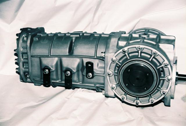

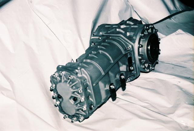

Here is the PDF of the lay out..
It had a 8" hypoid gear set... cut on a Ford 8" ring gear..
Mounted on a 9" carrier..
View attachment 850QC Dims.pdf
I would love to build a new unit based on what the new parts on the market... And it will fit into a GT40..
So are you driving the pinion through a hollowed-out cluster shaft? And how exactly did you attach the pinion to the transfer shaft?
Which parts would YOU use in an updated 850QC Delynn? I have no desire to compete, though I wouldn't mind collaborating if you were so inclined. This has been my goal all along...an American transaxle using American sourced components.
Keep in mind, when I made the 850QC,
Richmond only made the street 5 spd... NOW they have good OD gear sets.. SO I would use the Richmond gear sets, The same R&P but Diff Ratio... and DROP the QG gear set.. This will make it short enough to fit in a GT40..24.75" plus bellhousing..
so it you use a ZF bellhousing Total is 29.25" Tilton bellhousing 30.10"
I belive, the size of unit, cost me sales...
The new lay out would keep the CL of the Crank and Drive flanges would remain 1.75".. Block to the CL of drive flanges, about 10.5"..
The big change is in the rear.... much shorter..
