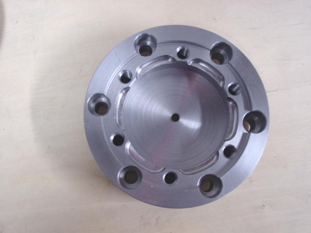

Doug,
Do the 930 CV's have those protrusions between the bolt holes. If so, wouldn't your adapters need scalloped cutouts to clear them? Here's an adapter for an 01E (with the larger tripoid flanges) to Porsche Carrera CV's that I made up. I believe my CV's are the same size as 930's.
Andy
The face on the 930 CV's is flat, however at max plunge the inner cage protrudes through the outer ~3mm and this needs to be allowed for in the adapter.
