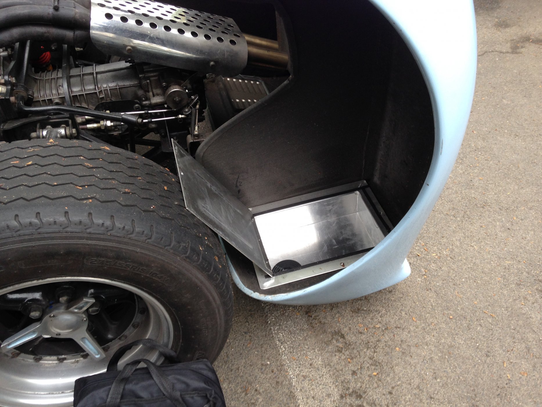

We get a soft bag under the front clip, small soft bags in each door and have the advantage of MKII style luggage boxes. Plenty of room for two people, helmet, race overalls, boots, gloves etc., and clothing for 2 -3 days.

I can't help but wonder if it gets mighty hot in those luggage boxes. Have you insulated them from the exhaust?

Hi Doug. The exhaust side is double skinned with an insulating layer between, and core flute board on the rest. All less than 8 mm thick, but keeps temperatures reasonable inside the boxes.

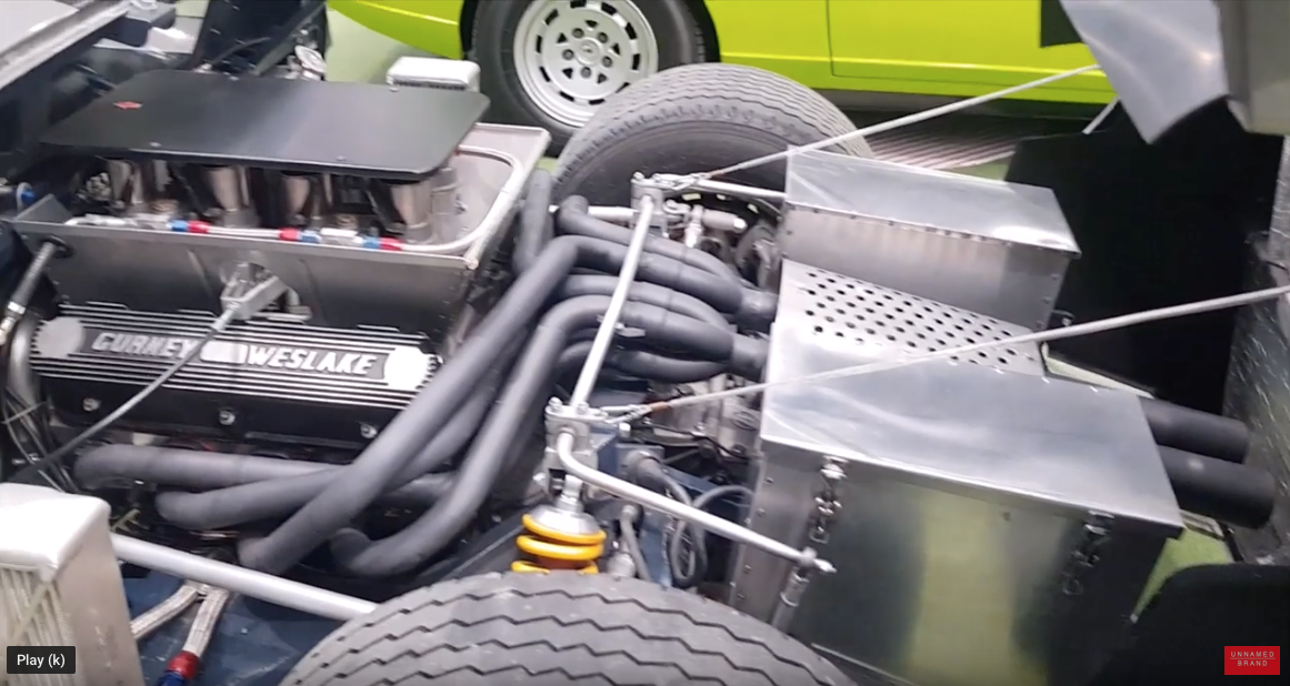

Hi Guys, one thing you could look at is the area where the rear lights sit in the rear deck. We installed two boxes that hold quite a few items, with a piano hinge and a bolt to close it its a neat solution.
