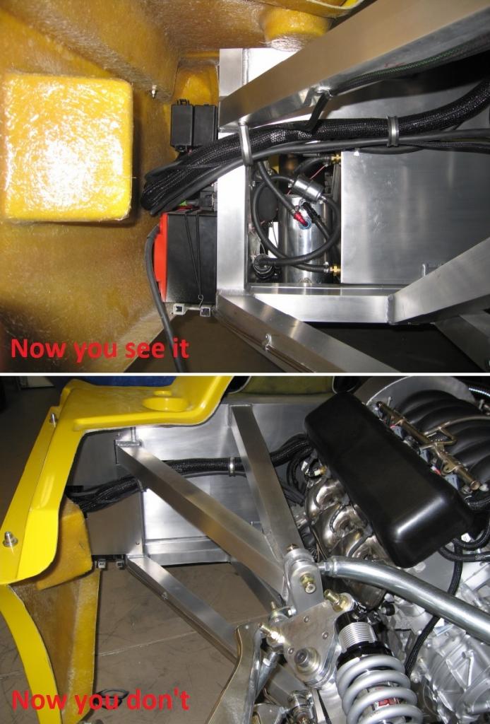

I put mine up front. I just thought it was cleaner to keep it out of the engine bay. I used one of the long ISIS power cables that the manual says to use for the front powercell to go to the rear powercell instead, and a 2 gauge cable to the starter.
PeteB
I assume that it a connection that ISIS supplies?
The ISIS kit includes 2 long power cables for the powercells and one short cable. The long cables are intended to go from the battery in the engine compartment to the front powercell, and the short one goes to the rear powercell. I'm using one of the long cables to go from the battery up front to the rear powercell and the other long cable and the short one for the front powercell.

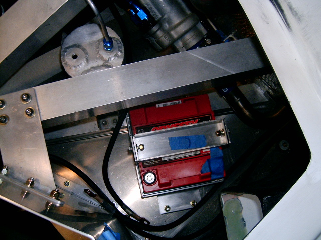

Howard Jones
I have a 925 Odyssey in my SLC and another one in my GT40. The one in the GT40 is over 10 years old. Never had to jump it or charge it........ever. Works perfect every time. Can't beat perfect. I'll post my mount arrangement when I get home or you can see it on my build page.
Howard Jones
Here's a couple of pictures from my build log.

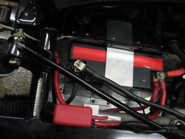

In case anyone is interested, here is a photo of a simple "battery box", if you have an underlying panel to mount it on. At the bottom, two pieces of aluminum angle at each end, riveted to the floor. These prevent any lateral movement of the battery on cornering. The simple strap over the battery is attached by four stainless steel button-heads, screwed into steel rivnuts. No Billet, but very sturdy, and very simple.
With minimal cost and fabrication, there is no way this battery is going anywhere!
