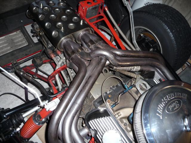

I did my old GTD in situ with a hand drill, tapped the fitting and installed the pipework without an issue. If you manifold is on the car I have my edelbrock airgap manifold off at present so I could do the measuring for you, just let me know. Generally you only need to to this mod if the engine is slightly nose down in the chassis which traps air at the back of the heads/inlet manifold.
Regards Martin.
