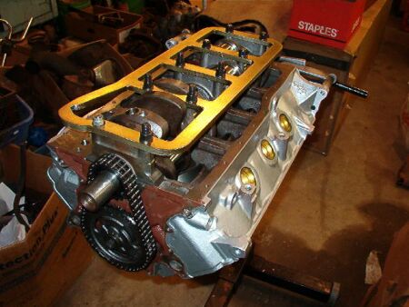

I am using a Boss 302 crank shaft in my engine. My unit is a NOS piece I have had from my owning a Boss 302 and always buying spare parts. I am using a Explorer Roller Block with the one piece rear main seal, so I cut off the flange by the seal surface on the crank and also installed a stainless speedy sleave where the rear main seal rides as the Boss Crank has slight grooves cut in the seal area because they used a rope seal on some. The Neoprene seal (one piece or two piece) works better with the grooves covered. I am using standard Ford dimention crank. I would have the crank magnafluxed and also ringit with a small hammer, as many of the Boss stuff was run pretty hard and they are 34-35 yrs. old /ubbthreads/images/graemlins/smile.gif
Vic

Here is a pix ofmy engine with the Boss Crank installed.
Vic
