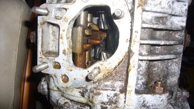

Just picked up a Porsche 930 transaxle with LSD, the numbers on it are 930 301 101 OR these are on the bell housing.
1. The end casing / cover has a weld repair which has distorted the machined surface so I suspect it will leak.
Could I have the cover machined flat and make a spacer the thickness of the material removed or just renew the cover, if they are available?
2. The gear selector shaft which runs front to back is missing are they available.?
3. Top plate is also missing, available..?
4. Where to obtain the above, 2nd hand prefered..?!
5. Who in the UK is recommended to overhaul / check it over.?
6. Are there any rebuild / overhaul manual available..?

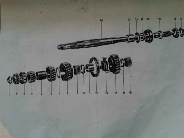

Here are the details of the companies used by John before I bought the box plus a pic of the shaft assemblies.
Cheers,
Martin

Thanks for the contact numbers, I think I need a plain gear selector shaft, one without any gears on unlike in your photos.
If anyone has a exploded parts list for these transaxles, I feel I could id it...!?

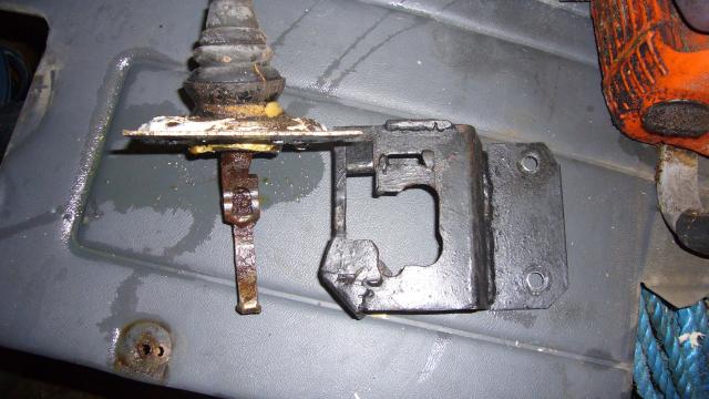

Dave, would you have any pictures of this "top shift" conversion that the previous owner had?? Sounds interesting..........
Hi Dave,
It was very make shift and he only ran it as a three speed, I'll will take some pictures, as it might be another way of tackeling the gear change set up...

Dave, no reason why you couldn't just machine it flat. After machining check that it seats properly on the gearcase and is not held out by anything like the reverse gear pin or touching one of the shaft nuts and you'll be right. If it won't sit up flush, a piece of thick gasket paper may be all that's required to regain clearance, or grind off the end of the pin
Seems to be some confusion about what you require. Your desciption above is quite straight forward and clear. I've got a spare trans, I'll pull the bits off it and post photos of them so you can see what they look like. Got to head off to work now, will post the photos tonight for you.
BTW. I agree with the run it and see approach.
Good luck,
Russ

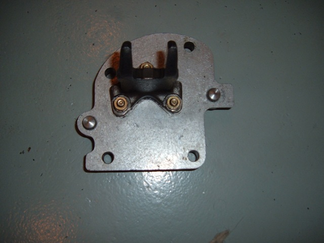

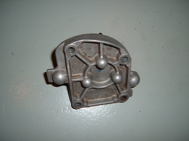

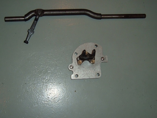

Here's what the bits you are missing look like.

Hi Russ, many thanks for taking the time to to strip down and photograph the parts, you are spot on these are exactly whats missing.
Would anyone know their part numbers...?
I would prefer 2nd hand, any suggestions on a supplier..?

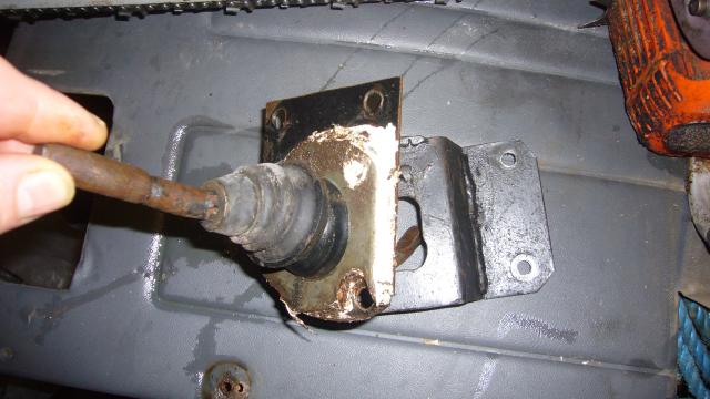

Here you go Dave, told you it was a little make shift to say the least..
