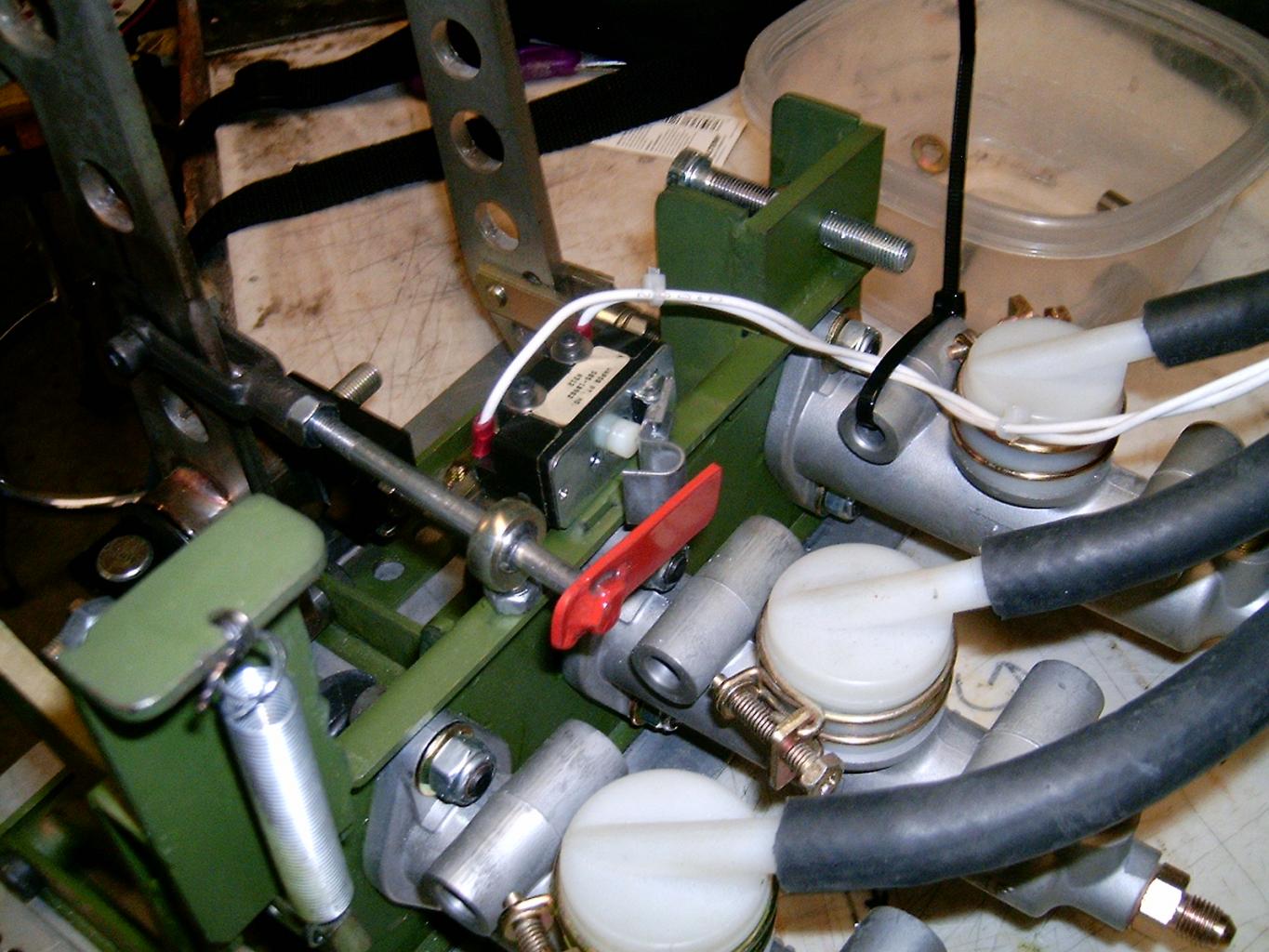

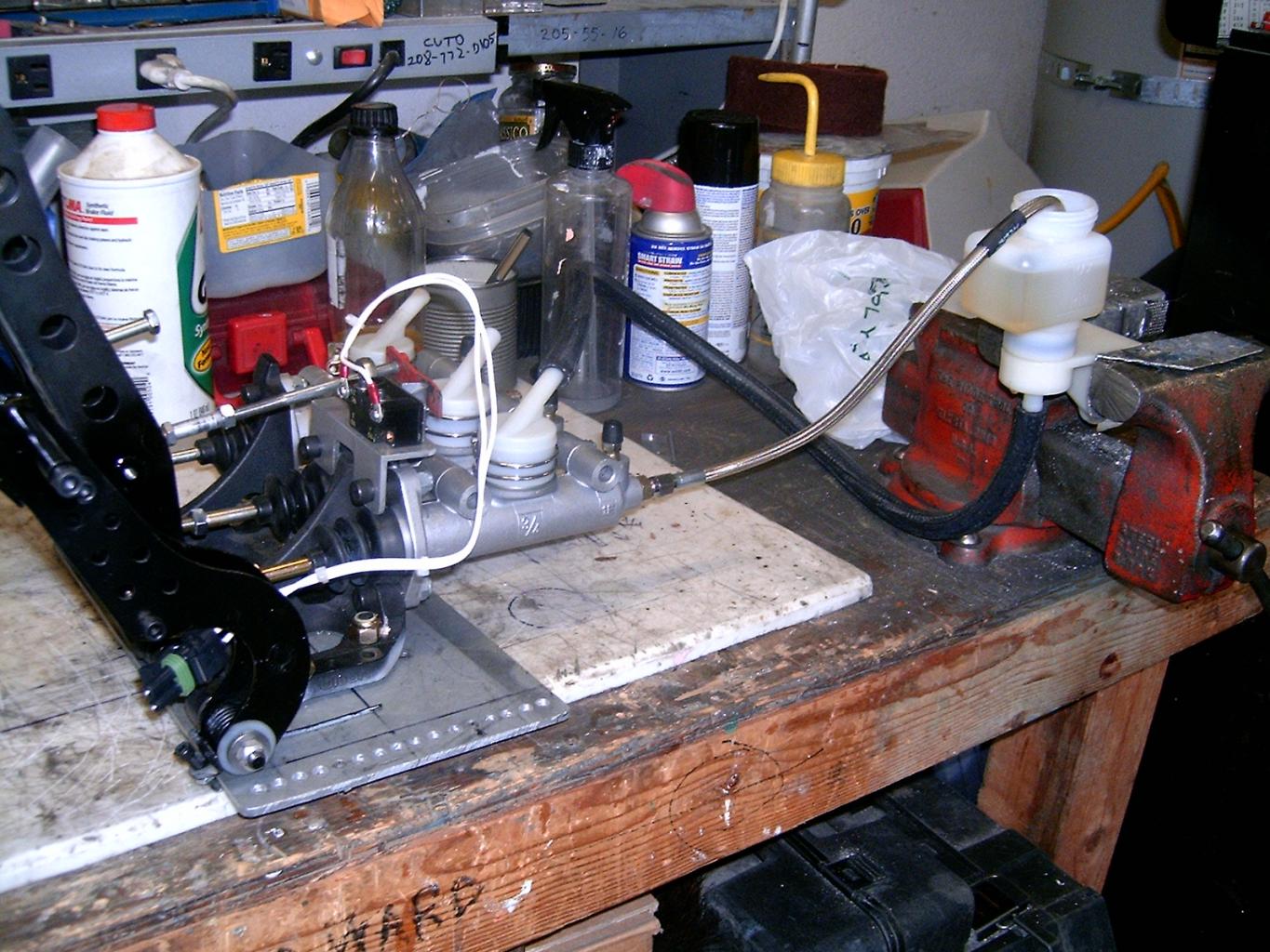

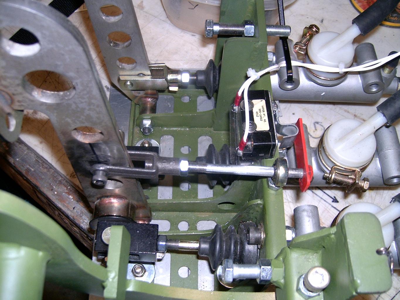

LED's used a lot less current that incandescent bulbs, period. I have had mixed results with brake pressure switches. The part I don't like is opening up the brake fluid system to change them. So..................................I did this. Later when I installed a Tilton peddle set I did it like the last one.
Miniature Snap Action Momentary Switch w/ Long Lever - SPDT : 30-2040
Lots of options for snap action momentary switches. And you can replace one with out disturbing the brake fluid system.
By the way I think the Japanese electrical parts for Hondas and Toyotas are better than Chinese (damn near everybody else in the aftermarket) or maybe try German stuff like VW or Audi if you stay with the pressure switch.
