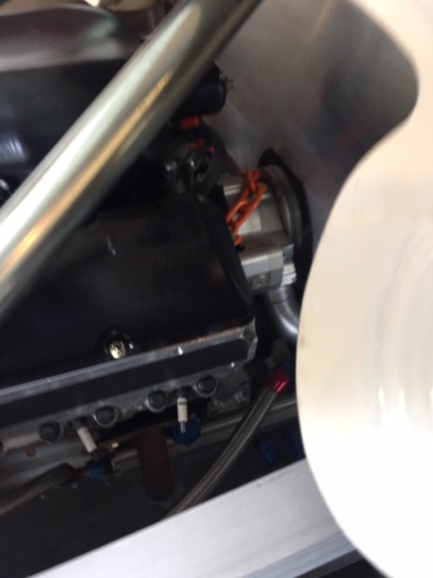

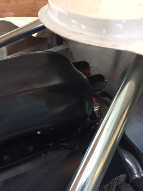

Thanks everyone for the responses! I guess my major concern is fitting it to my SLC with all the space limitations. Is there a specific bracket that would work for this application? And... What about the wiring? Is a one wire preferable with the Infinity Box? Finally, would it mount on the driver side or passenger side (I assume driver side?).

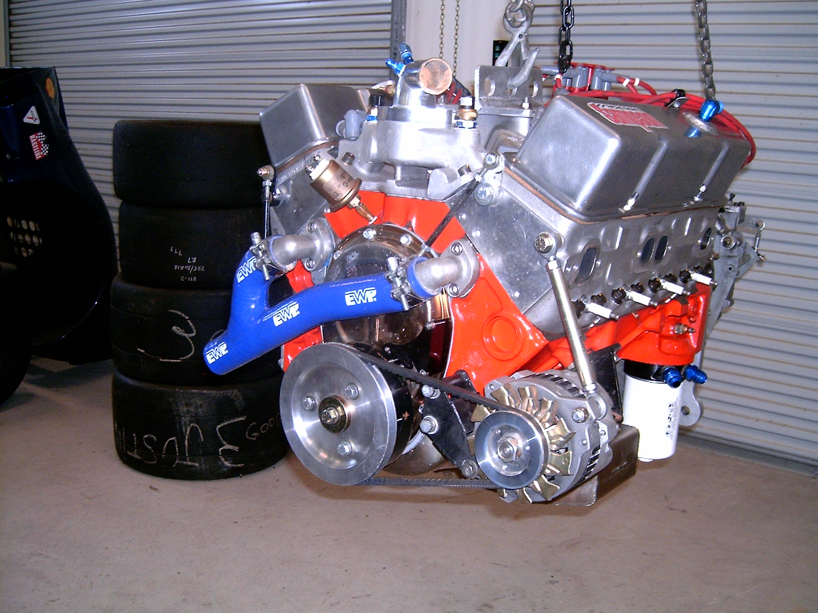

Mine was a simple affair with a long spacer. The hardest fabrication came out of a 1/4" thick aluminum slide bracket. No welding, but may not work if you've got some ancillary stuff being driven off the damper/pulleys. The first photo was using an OEM bracket just for positioning, but not used in the final assembly. The last two photos show some of the actual pieces used. Very simple, and low to the ground. Used the OEM holes in the block, with one bolt on top to allow pivoting, and the slide bracket at the bottom to allow adjustment along the slide bracket. Doesn't look real rigid, but it is.
