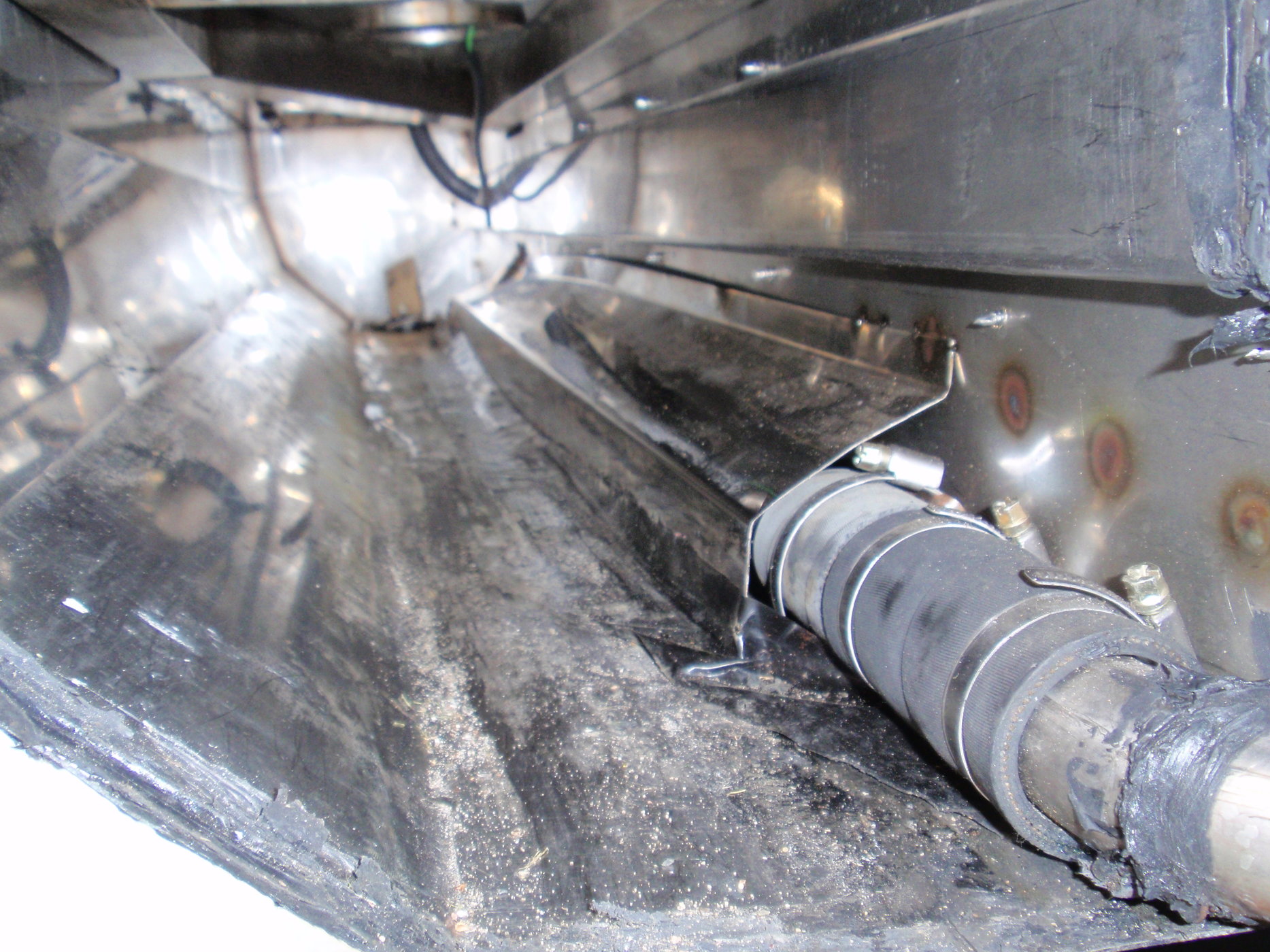

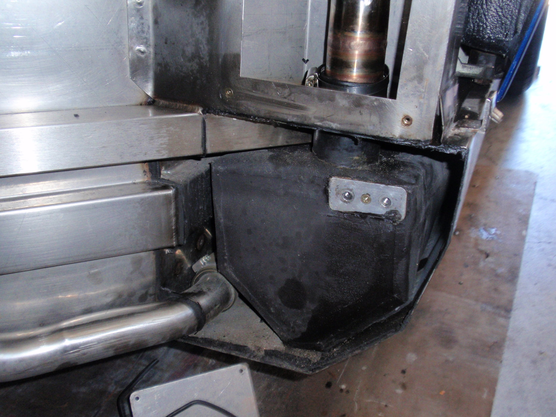

Pat
Here's what you'll probably find when you pull off the sponson shroud and fiberglass end plate. You should be able to tighten the front clamp without pulling the cell. The rear clamp may be more troublesome depending on the location of the clamp.

NickF
Thank you pat, this helps. I figured as much, rear clamp might be hard to get at. maybe a small ratchet wrench. If I have to I will weld my own tool, rather than have to remove both fuel bladders.
Pat
Nick, the bladders have some flex in them and you may be able to get to the far clamp with an electric ratchet.
If you need to get the cells in and out, PM me and I can give you the way I've found best to do it. I can get one out in two beers or about an hour and a half.
