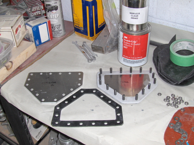

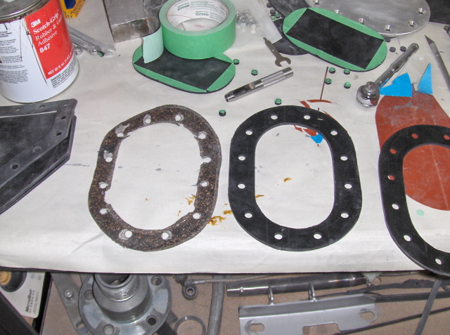

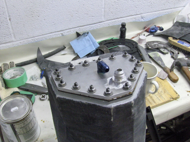

Can you post some pics of the damaged tank fittings? We stock fuel cells if yours are not repairable.
CAV Canada has done CAVs with 8 stack EFI systems with the fuel plumbing, returns and tank selection all sorted out. I like to keep things as simple as possible.
Something else from the skunkworks here are Nitrile Gaskets to replace the cork gaskets on the top of the fuel cells, a new end plate system that eliminates the top ports and provides for intank fuel pumps, plus servicability through the rear compartments (so you don't have to take out the tanks). They can be set up for a balance pipe for single filler neck applications too.
So please feel free to call on the no charge tech line for a chat. Whatever you need chances are I've got it or been there and done that!
