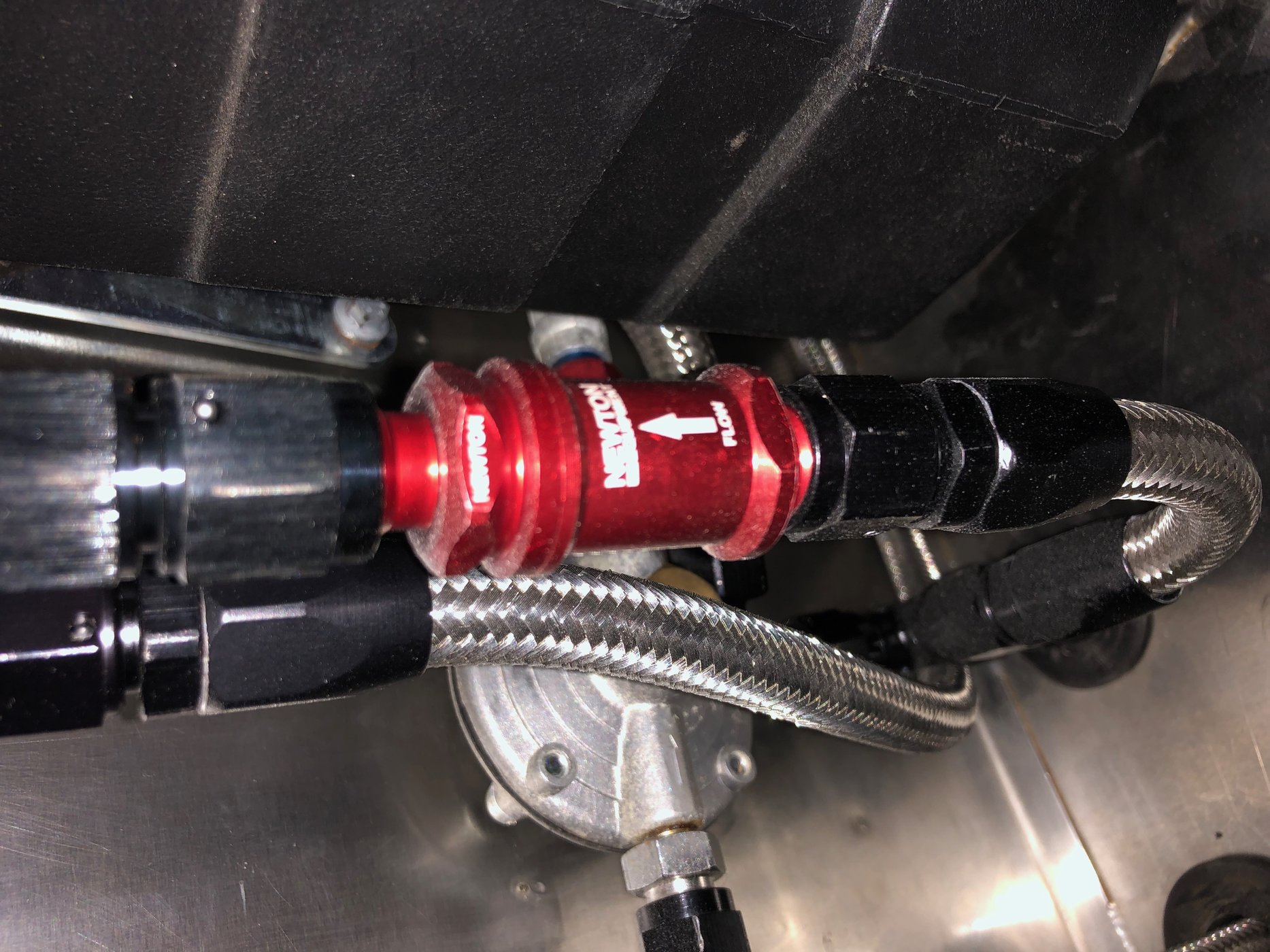

I decided to re design the fuel system around the tank.
First: i switched to the new alu tank from CAV

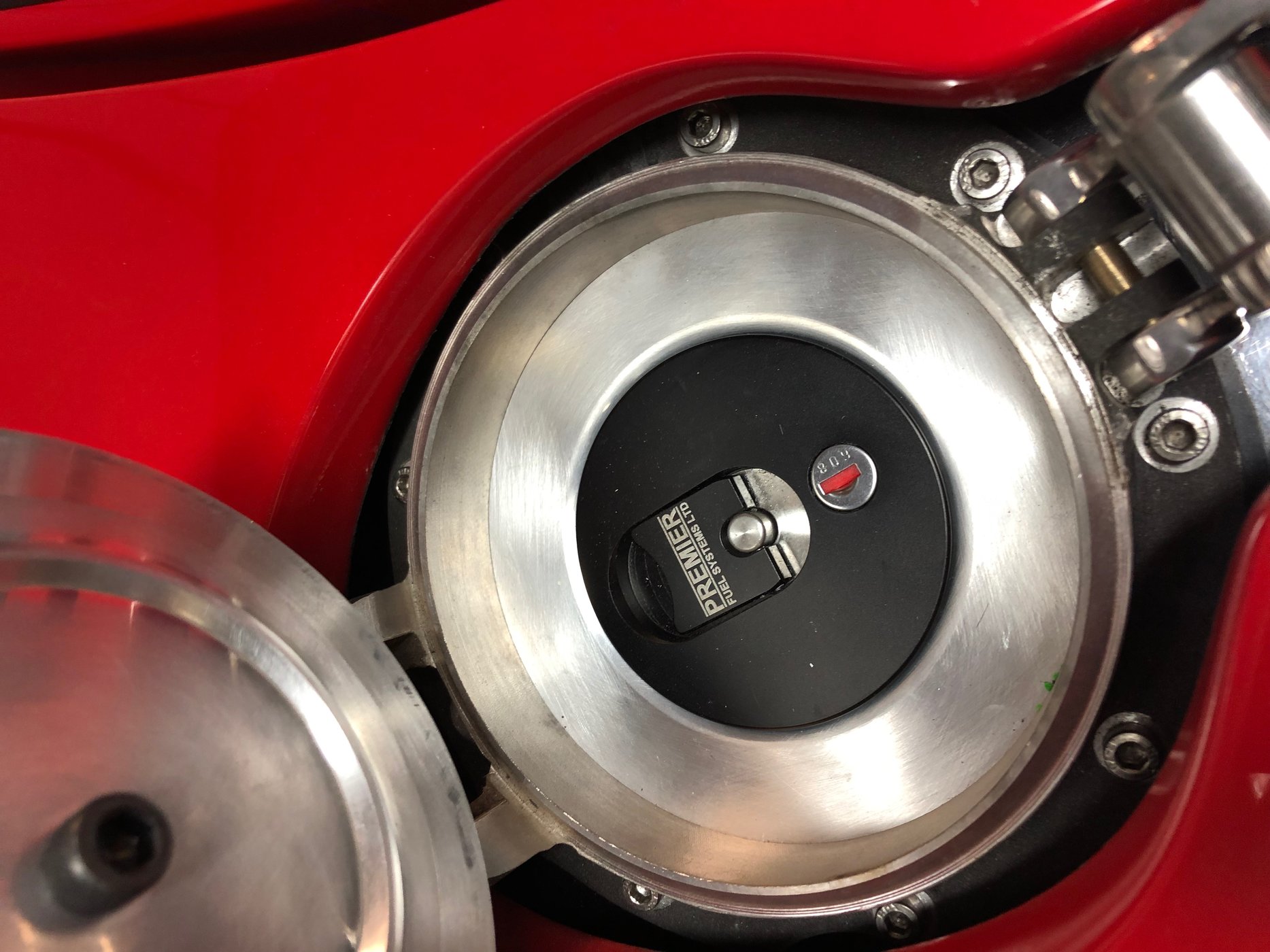

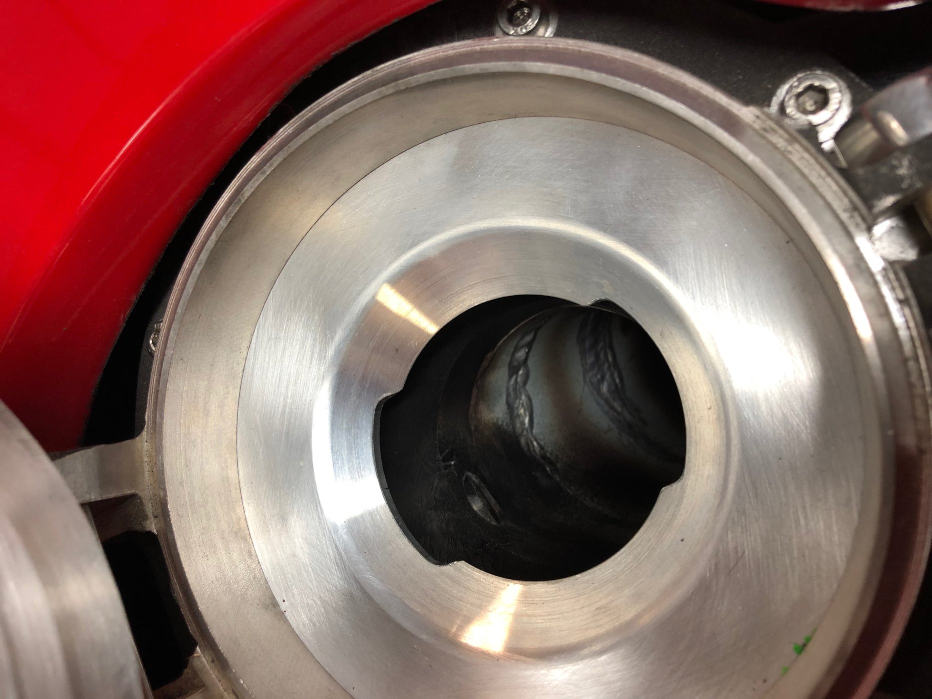

second: i replaced the fuel caps by sealed fuel caps from Gelscoe. i also redirected the overfow fuel pipe inwards in the tube.
third : as fuel caps were no more vented, i vented the tanks on the rear side by installing rollover valves

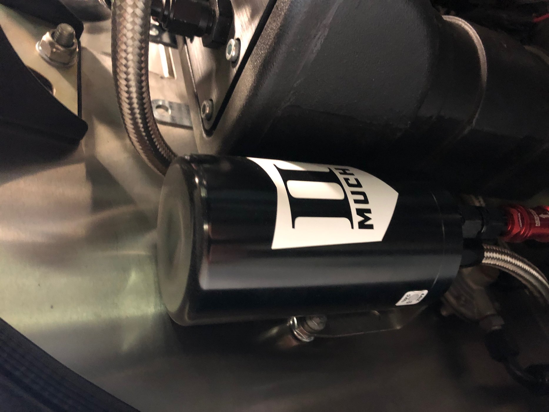

fourth : i put a 2 II Much canister on each side to collect fuel vapor.
and now its 100% clean !
see attached pictures

I'm ordering 2 new alu tanks from CAV as well. Are there any other ways to make the fuel gas cap from 'venting' to sealed? I see you bought some from Gelscoe, but they look like 'regular' aftermarket caps somehow.
Also, from your 2-much canisters, where do the vapours go? You route them to some place, or just in your engine bay.
