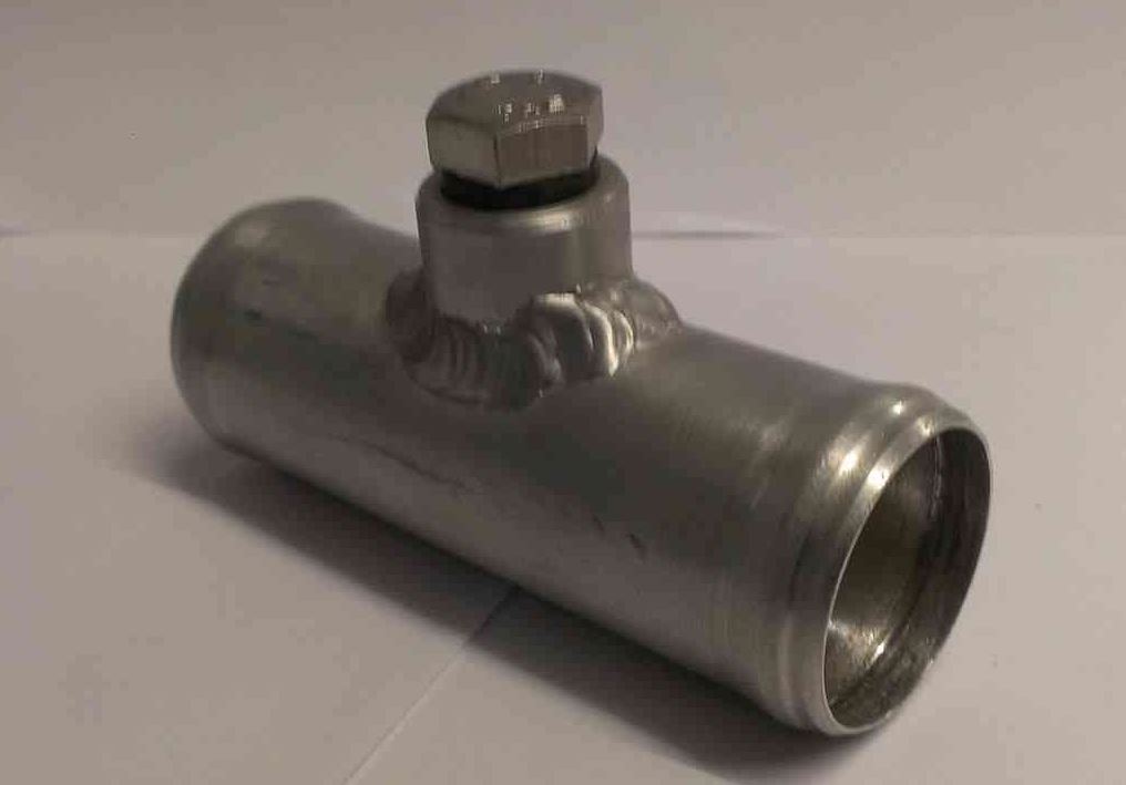

2. Install a small nipple bleeder in the front rad - best if it's soldered right into the rad at the highest point in order to burp the forward portion of the cooling system, but if it's plumbed in the upper rad hose that's not bad. Obviously, not very "original" however (see pic).

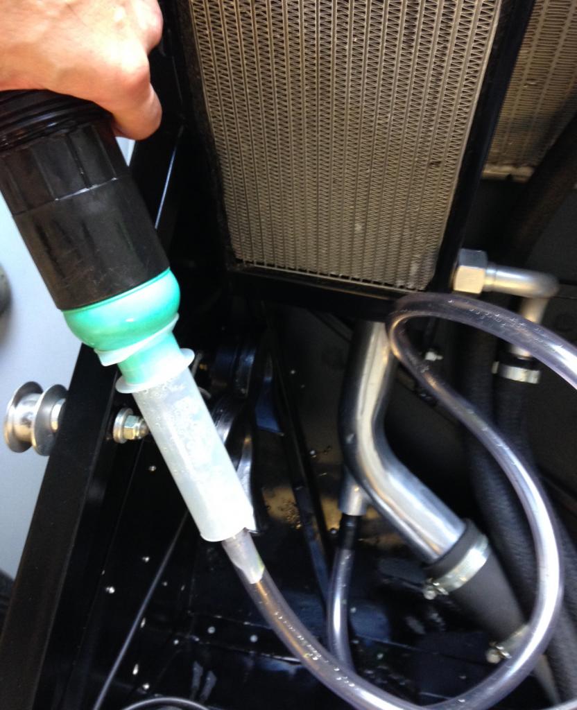

Proper equipment can keep this task from being a mess. Items that have proven useful include a large capacity (14 gallons) wet-vac device, clear liposuction tubing (8', 3/8" available from Henry Schein), electrical tape, Teflon tape, and a medical grade irrigation bulb syringe (Vitality Medical and others).
Begin by adding electrical tape to the end of a 4 to 5 feet long piece of liposuction tubing to make it fit more tightly into the temperature sensor port. Cut a hole in the top of the green bulb of the irrigation syringe that is at least 1" in diameter. Stuff the bulb into the end of the wet-vac tube (no attachments) half way so that there is a good seal. Unscrew the temperature sensor after disconnecting the two wires, pull it out and quickly insert the end of the liposuction tubing. Turn on the wet-vac and take out the two burb bolts at the top of the radiator to allow air to enter the system (photo) After no more coolant comes out disconnect the syringe and put the end of the liposuction tubing into a pail.
The photo shows the oil cooler at the top with part of the radiator visible behind it. This is the left side of the car. The aluminum radiator tubing is seen in the middle. Note the temperature sensor port with the liposuction tubing plugged into it. The irrigation syringe is shown inserted between the end of the tubing and the end of the black wet-vac tubing.
