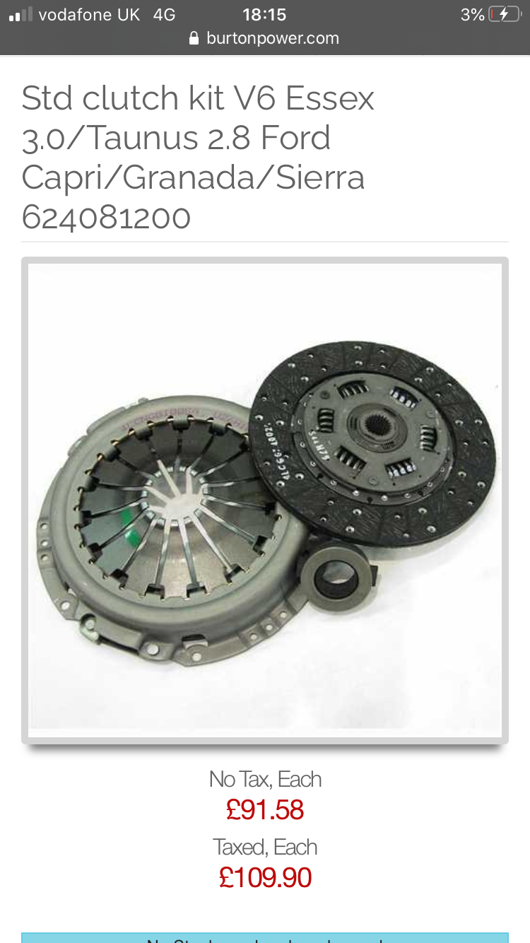

something like this?

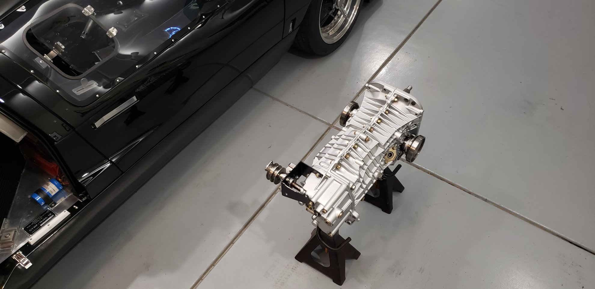

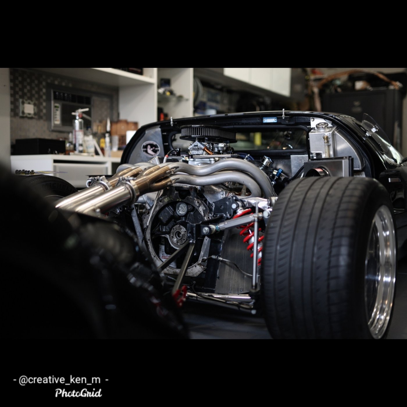

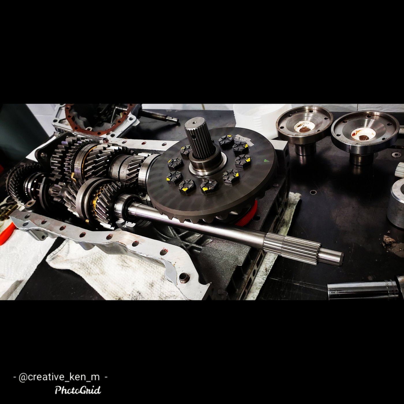

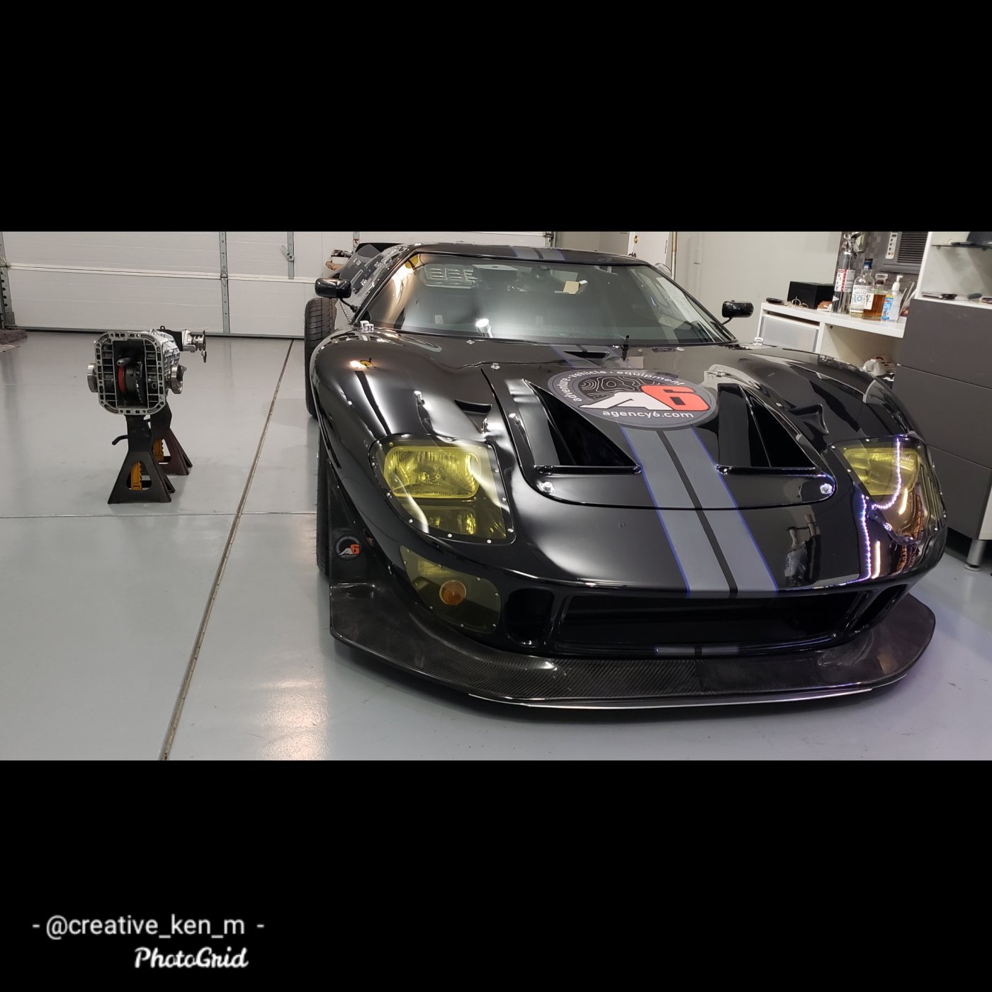

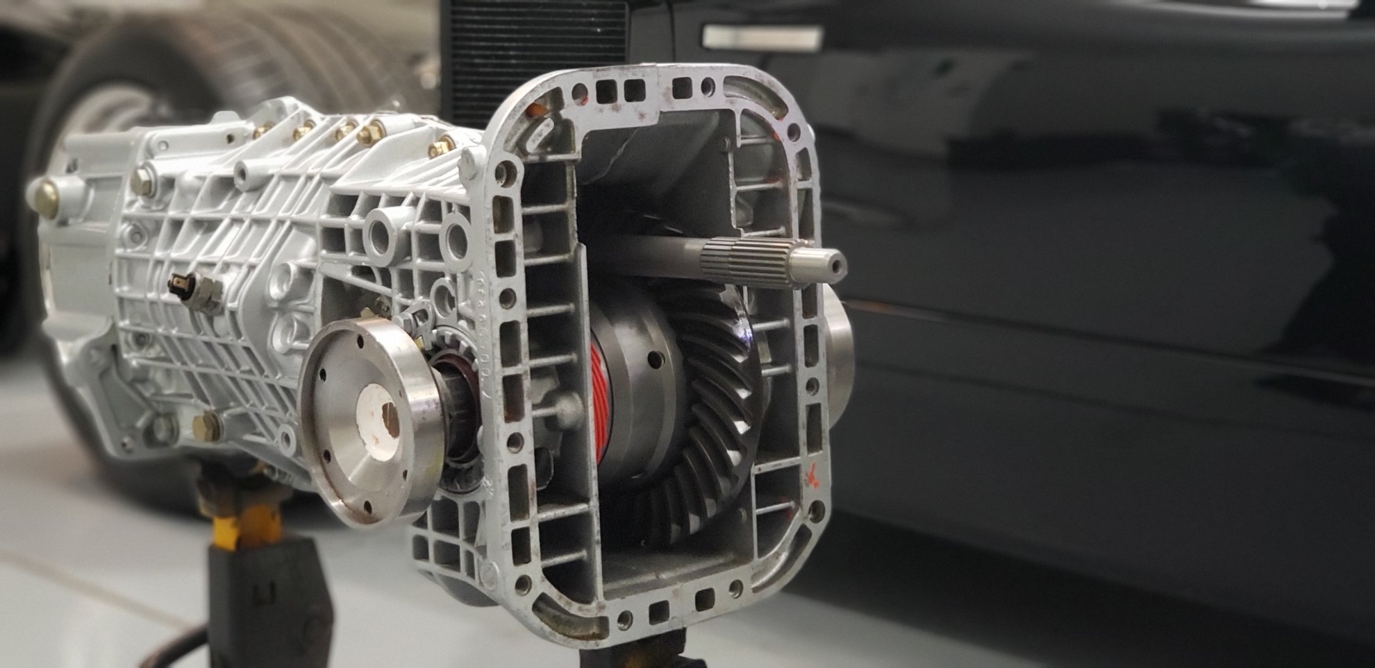

Got the UN1 updated finally! Here are some pics.

Thank you! Yes it is. It came with the headers you see, but I fabricated the straight pipes and v bands and welded them to a new set of collectors.
I was looking at your photos on Instagram. Is your vehicle a gtd40 body? The engine is 302? I got gtd 302. A little change of the engine from now on. I'm thinking of installing the Holy Sniper efi. I'm thinking about an exhaust.
It is. It a GTD indeed. I have the original collectors and piped still as well as a few things if you are interested. I am also going to be changing the wheels and tires for a track set soon. How do you like your GTD?
