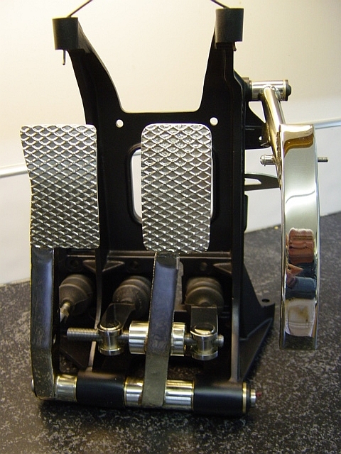

Pic of pedal box assy to save you getting stuck down in the footwell.
