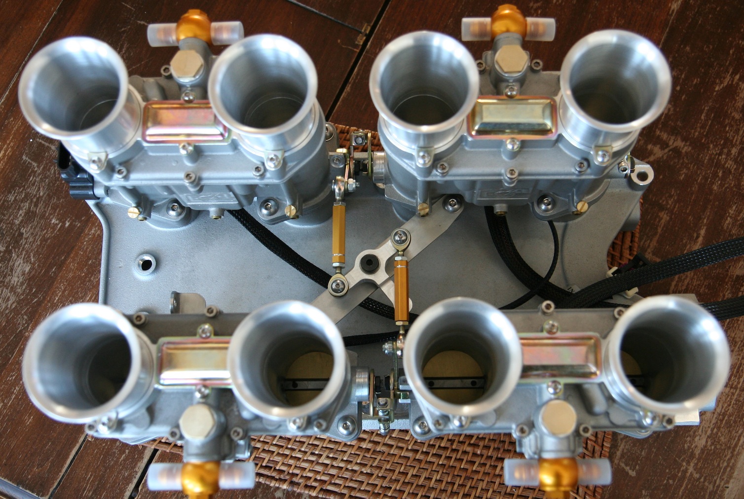

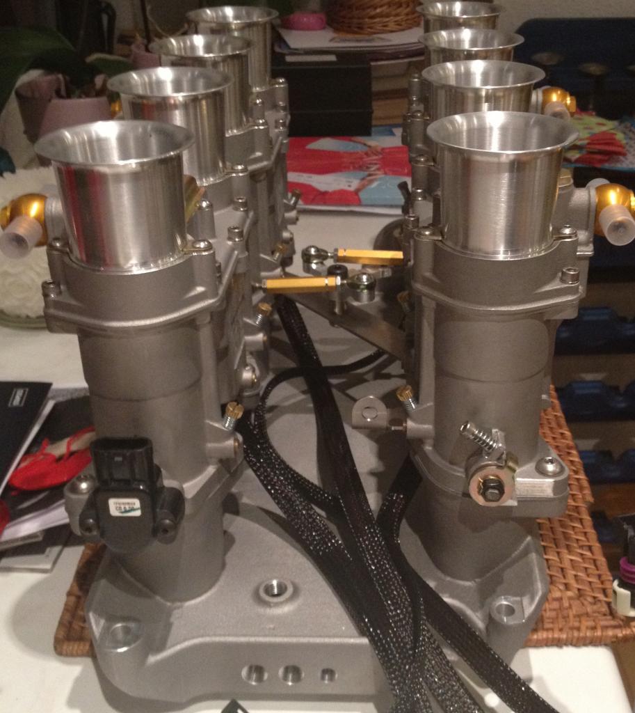

My fear is, I will never find it out what went wrong....However, I have a spare 289, 302 and 351 sitting there, so if I go with the 289 or 302 I can reuse heads oilpan and so on, so not to bad......Whatever is going to happen over the next weeks, I am really looking forward to put this all together and run my 8stack EFI on top of it :)

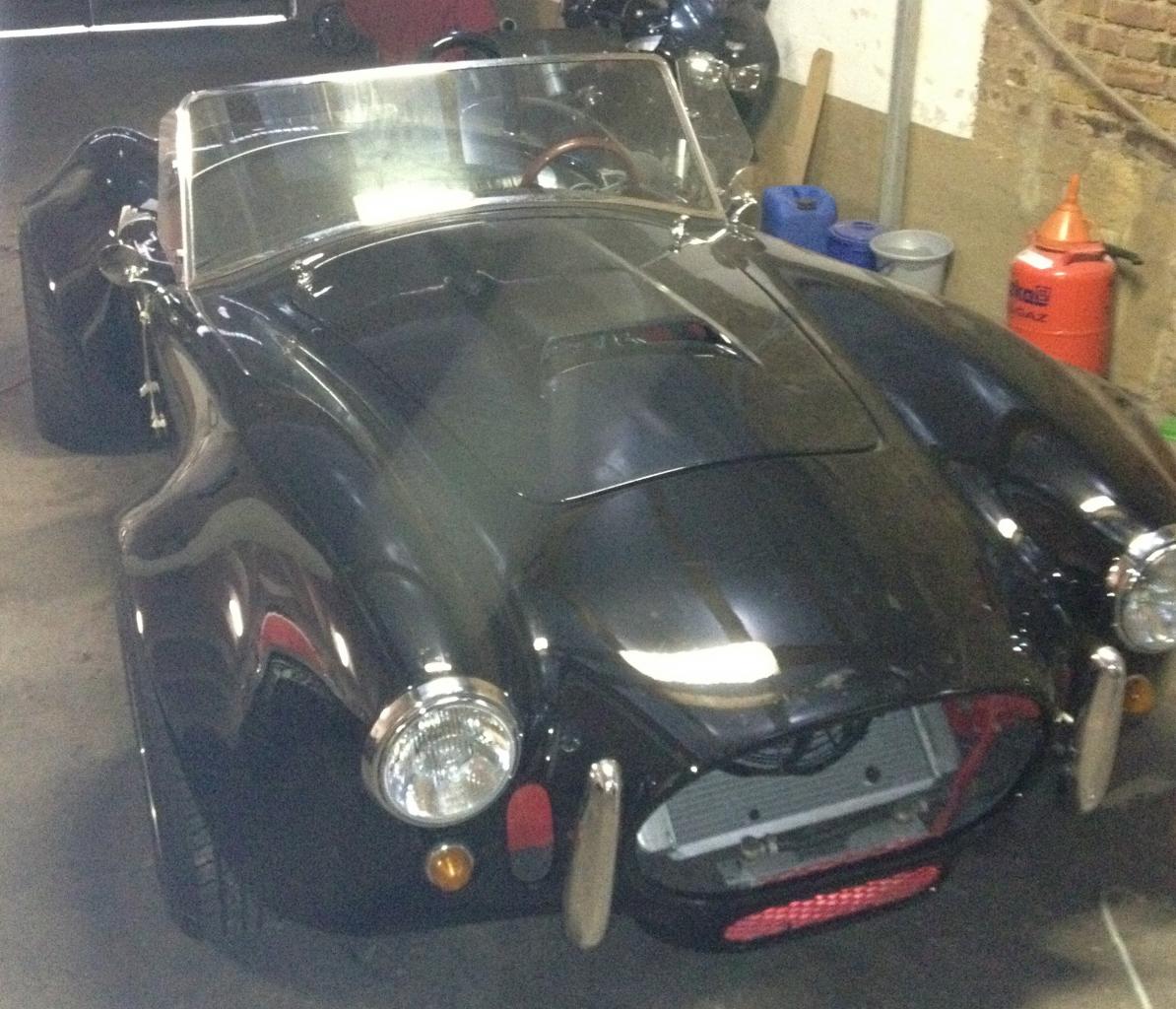

So now back to the garage the GTD build is waiting....And next week I am taking after four years of restoration my Cobra to inspection, summer is not waiting .....
