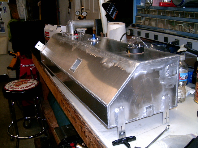

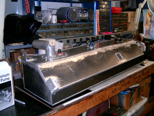

Here is a picture of my home made pickup. It draws from a 6X6X2" sump in the center of my tank.

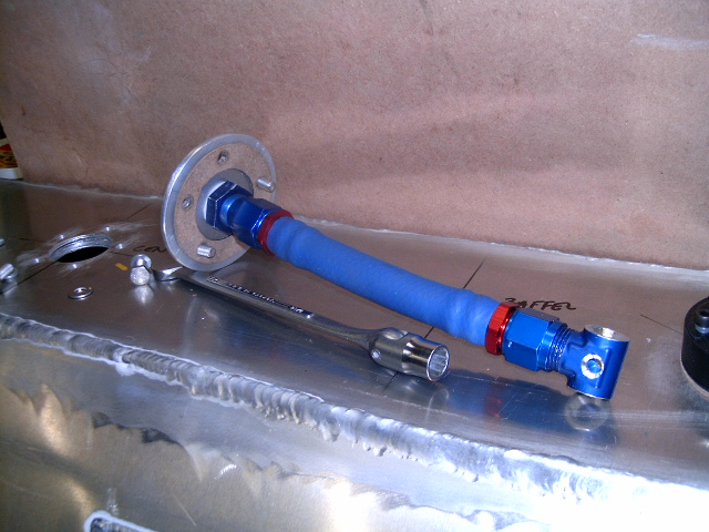

Okay, re-design is happening. One last issue I'm trying to workout - the fuel pickup.
The way I'm going to have it done is a 3/4'' tube welded onto the bottom of the TOP of the tank that goes to the bottom sump area. Then the top area will be drilled out for a -10 weld-in fitting.
Now what I'm wondering if the distance from the bottom of the top of the tank to the bottom of the sump is going to be roughly 9''. The pickup tube will be welded onto the bottom of the top of the tank, but nowhere else...... with fuel sloshing around and banging around, what's the chance that the force of the fuel (even with proper baffles) will eventually crash against the pickup enough times and cause it to break off?
The only way I can see improving this is to weld the top of the pickup tube to the tank, and then weld brackets on the inside of the tank and the pickup, then bolt the pickup with metal lock nuts to the tabs for additional support
Dropped the tank off with my friend for re-construction.
The one tricky part will bet he pickup - he has an ingenious way to secure the pickup tube at the bottom (a set of "arms" to hold it in place), so that's good. The problem though is the pickup tube.
I'd like to make it removable, sot he current idea is:
-weld a -12 female bung to the tank
- get a -12 male fitting and weld a 3/4'' tube onto it. thread the male fitting into the female and bam, instant removable pickup.
HOWEVER, all female bungs are o-ring sealed. All o-ring AN fittings are straight cut (vs 37* flare) and usually have 2x the amount of threads on them. It would be impossible to weld a pipe to this and not damage the first thread or two such that it wouldn't thread in.
So I'm wondering what the solution is.
The best idea I have is to take a regular 37* flare'd fitting and stick the o-ring onto it. However, would this seal? I honestly have no idea....if it would seal it'd be dandy because you could weld the tube onto the flare, and the threads form the mechanical bond, and the o-ring forms the no-leaky seal. However, I have no idea if my logic is right or wrong here.

My tank is baffled into three sections. The center is approx 1/3 of the total volume. The small sump is to allow for sloshing around and still keep the pickup submerged. The sump will also keep the pickup contained in the center/bottom of the tank where I want it.
I also never intend to run it until the last 1/2 gal as you might in a race. I will keep it pretty much 1/4 to 2/3 filled from session to session.
I looked at a lot of fuel tanks and most have a flexible pickup hose with a pickup on the end of it. The dirt track guy I spoke with said that he and others use a flex hose because the hard line will break off at the top mount. There is a lot of leverage on the end of a 10 inch long piece of tubing. The forces applied to the end of the lever, with the pickup acting like a sail, by several gals of fuel washing around inside tank is enough to break it off sooner or later. At least he thinks so and so do I.
I believe that whenever possible its better to be able to service/repair systems by simple disassemble than by destructive methods. In the event of a failure, my pickup can be removed from the tank for hose replacement, for instance, very easily. Your idea will require you to cut open a used fuel tank and weld in a new pickup tube. The fill plate is so that I can replace the flapper valve or roll over check valve if necessary. Again easy simple service.
If you have ever cleared a used gas tank so that you can weld on it then you will know that just cleaning it will take a lot of work and time. Some people won't ever weld on a used gas tank.
To each his own I suppose.

Basically it'll be a female -12 bung welded to the tank. Then take a -12 to -10 union. On the -12 side weld on a piece of 0.7 pipe to the flare. Stick an o-ring on the -12 side, and screw it into place. To ensure the tube remains braced and goes to the proper place, we'll have several "arms" on the middle of the tank and around the sump. The pickup tube will go through these arms and be held in place by them.
That bracing should be enough to distribute stress as fuel is sloshing around.
And failing that, we can always play extract a .7'' tube through a .75'' hole :eek:
Although I suppose one could do the same exact thing, except use a fill plate cover in the area so if the pickup ever did break off, it would be easier to extract. Hmmmm.
The tank material doesn't seem thick enough to drill/tap for 1/4 bolts .... are you using a nut ring, or did you weld aluminum "blocks to the underside of it and drill/tap those so you have some real meat to bite into?
