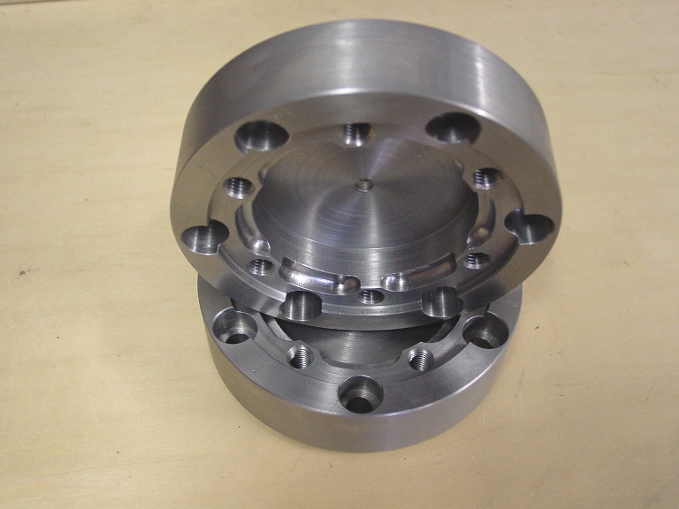

Hi All, It would appear i have 114mm flanges. The Sierra standard Lobro joints are either 100mm PCD or 108mm.... So it does seam like adapters will be required. Is there a problem with using tripod style outer joints and Lobro style inner?
Steve
Hi Andy,
Did you buy them, or make them? Does anyone know where might have such a thing on the shelf or ability to design and make them?
Steve
Hi Andy,
Steve
Steve,
I made those some years ago. Can't say who might offer such adapters, but perhaps the guys in AUS or NZ, where the 01e seems to be quite popular in their GT40's, may know.
