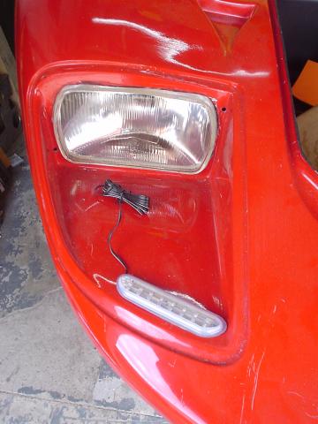

Here you go, here's a pic of the LED indicator strips I bought a few years ago and I plan to put them somewhere near where I have placed them.

Thanks for that Brett. I've seen those on e-bay - do you plan on keeping them there after SVA ?

Simon, yes I plan to keep them there after SVA, but will probably recess them in, whilst I may raise and angle slightly for SVA.
Make sure whatever you buy has the appropriate E Mark.
