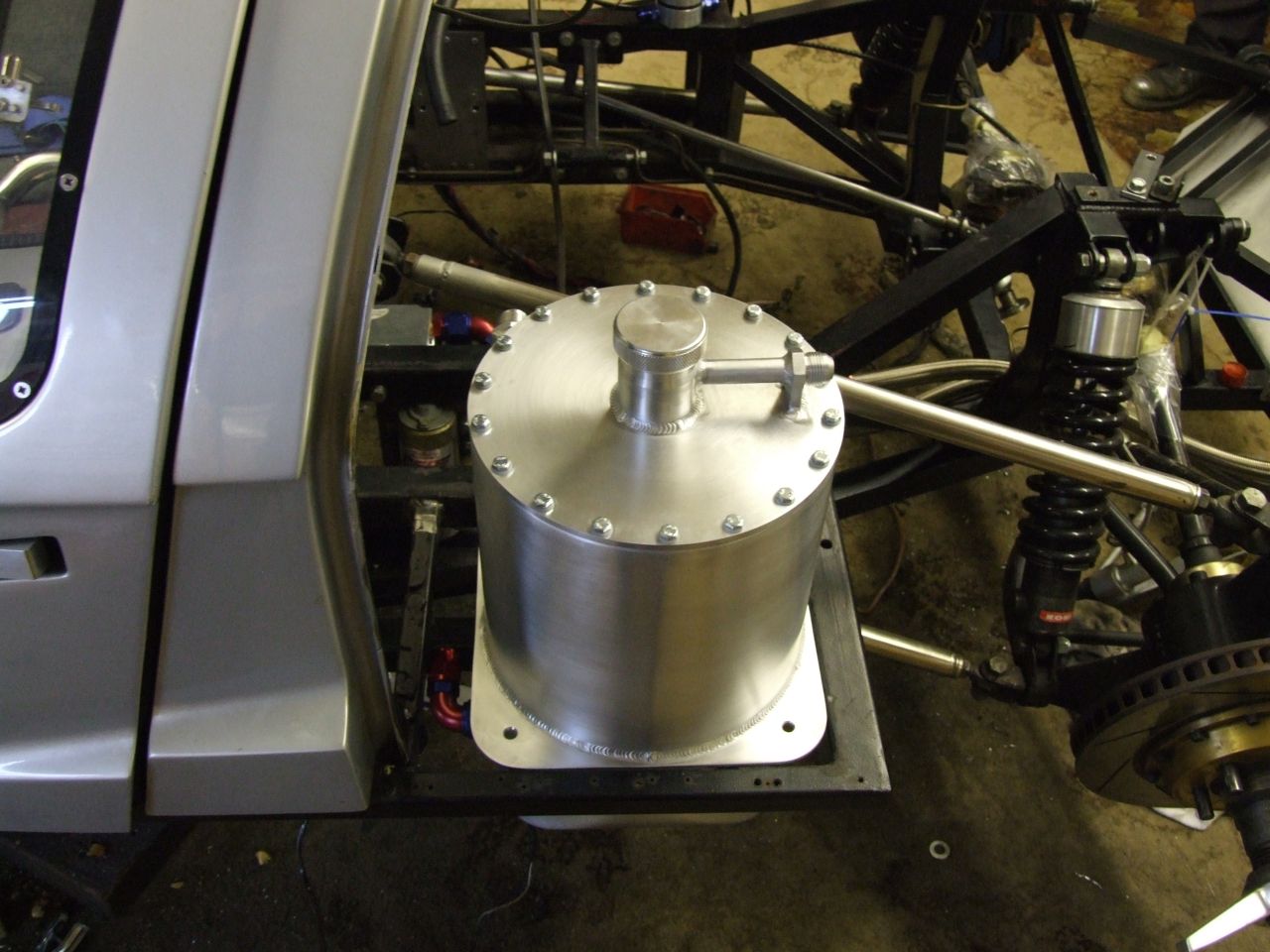

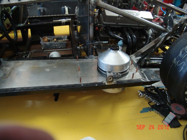

My GTD version
Neil

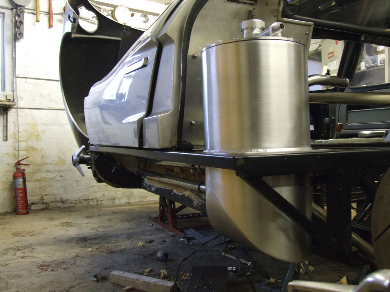

That is similar to the way I did it when I was building my Homebuilt 10 years ago. I did not use a dry sump but thought it wise to put one in at that point in case I changed my mind in the future.
