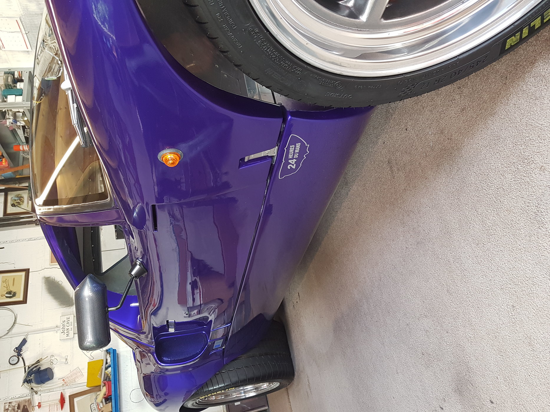

Hi Udo m8 these are what i have used ,,

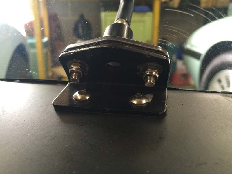

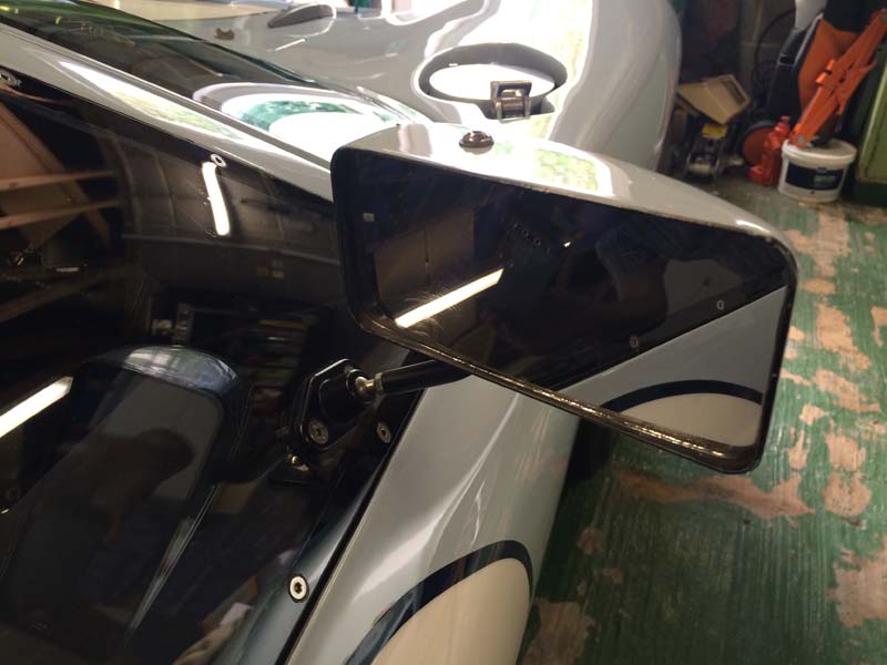

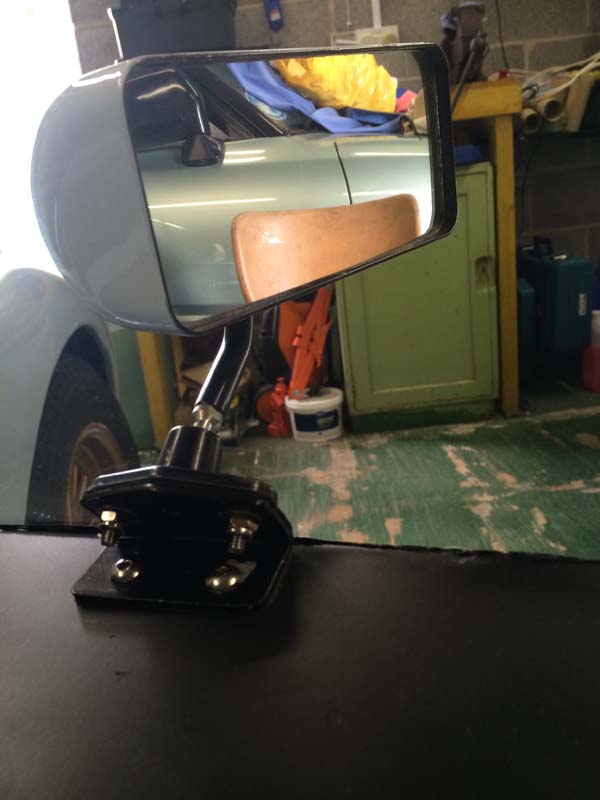

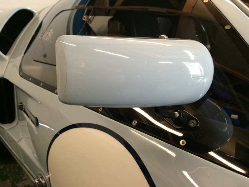

I use SPA GT mirrors with convex lens. I have found these to be excellent for both road and track use giving good rear visibility. I have mine attached through the side windows onto a bracket bolted to the door to minimise stress on the window if they get knocked. As well as holes for the fixing bolts there is also a hole to allow access to the grub screw that tightens against the ball joint at the bottom of the arm.
Dave
