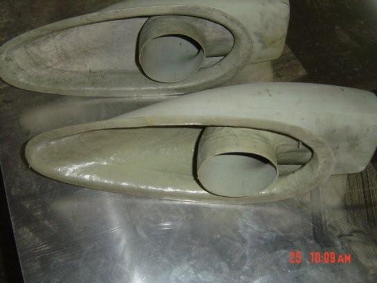

Hi Bernie, I'm nearly 100% sure Roaring Forties have these available.

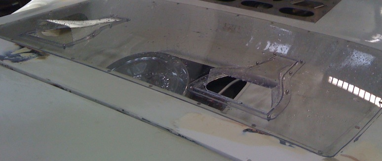

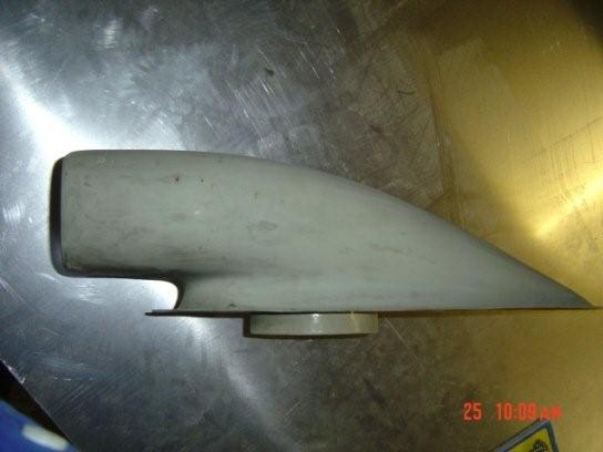

Attached is a picture of the rear clip of an original GT at the Shelby Museum. It is a poor picture, but if you look close you will see three or four slots, about 2" high, horizontally placed on the rear glass.
I have also see the aero vents to which you refer, typically along the trailing edge.
I have alse seen a pic taken in the late sixties of a GT that had a single opening cut in the glass, about 12" long, 2" high, near the trailing edge, presumably because of the proximity of the collectors.
But in reality these aids will help only when the car is moving. A couple of vent fans to move the air will be much more effective. There is detailed post describing this idea on our build blog. I suspect a similar arrangement might be feasible for you. I can tell you that after several hundred miles the vent fans have proven very effective. When we stop the car after a good ride they are left on for about ten minutes. It is amazing how hot the air is that is expelled out the rear of the clip. It is also amazing how quickly it cools down with a good flow of air.

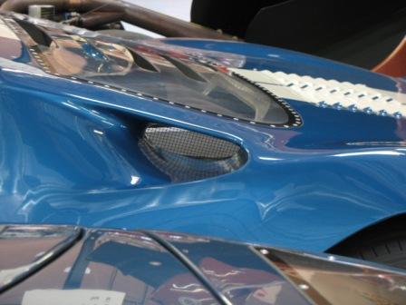

Re: MKII vents
Hi,
this is how I solved it, during driving it blows air into the compartment and in traffic jams you can see the hot air escaping through the ducts, so no air jam there.....
(C)arlos

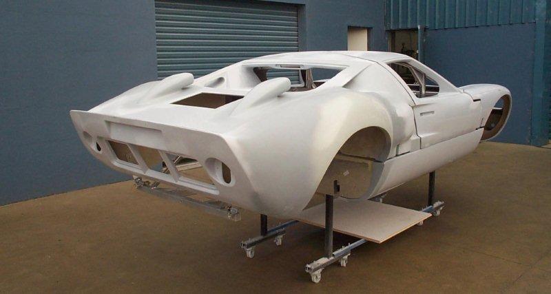

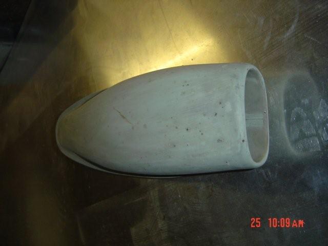

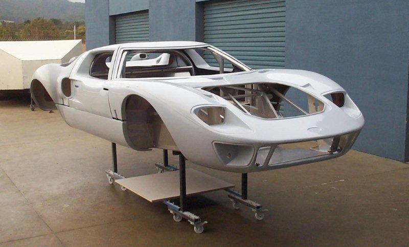

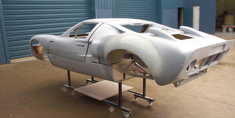

Hi Bernie, the body pics are not of my car, but just some the RF gave me a while ago when asking the same question (and about the wide flares).
Paul also sent these, so yep, looks like they do come as separate items :)

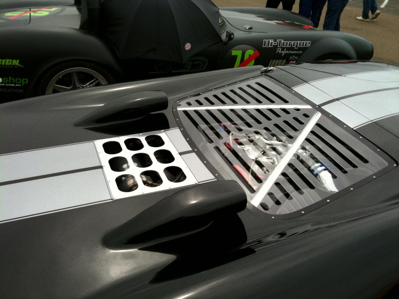

Here is a pic of air vents and scoops to cope with turboéd 900hp plus (road registered car here in Oz).
