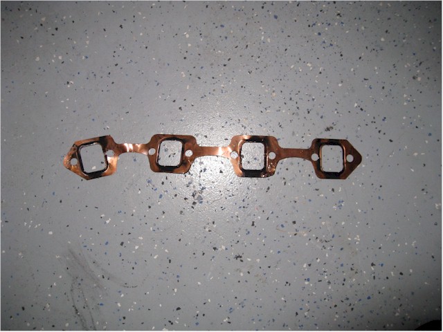

I've been chasing and exhaust leak. One of the header flanges moved a bit during final welding and leaks at the bottom. I started with FlePro 1415 gaskets. I decided to switch to some thicker copper gaskets from Summit. You can see how well that worked. :sad::sad: I went back to 1415s and doubled the gasket material on the suspect flange. Seems OK for now. Any thoughts?

Copper gaskets will only work if both surfaces are completely flat and true with each other.
Using thicker gaskets will work in the short term but you will find they will still blow out as they age and will require regular replacement.
The only permanent fix is to machine the mating surfaces to sit flat with each other.

Agree with Jim and Dimi, you must have a header flange which isn't quite flat. As Jim suggests, no need for a machine shop, just put it on a good sized bench belt sander to take off the high spot or two.
Put a little grease on the flange bolts as you're torquing it down - this will help it go down equally and the grease will burn off the first time you get her up to temp - anti-sieze is good. Finally, use some Permatex Form-a-gasket on the flange side of the gasket as this help to fill small voids (don't use on both sides as you might not get the flange off again).

I like the copper gaskets (beaded ones) but I use Permatex Copper or Red High-Temp RTV on both sides to help fill in any voids. I let the RTV "Skin-up" on the gasket for about 20-30 minutes before I install the gasket. Anti-seize of the header-bolt threads. Install the header and lightly snug up the bolts. Let cure for 12-24 hours and then torque them down the rest of the way - this compresses the RTV even tighter around the gaskets.

Three of the four are very close. The fourth has clearly shifted but doubling up the gasket material seams to have resolved the issue. It's hard to justify cutting and re-welding the pipe as the headers are ceramic coated. I put some miles on this weekend and things look good. Chalk it up to one of those "If I knew what I know now, then" experiences! At this point the focus is on putting on the miles as opposed to watching the patina form in the garage.
Your flanges need to start out THICK to reduce the chance of warpage. 3/8 - 1/2" material is recommended. Then, as suggested, the surface needs to be made flat again after welding. This is a MUST. If you don't do this, you will ALWAYS get leaks. Copper gaskets will work well, or so I have heard. I use the red RTV only method, and have done so for YEARS. It works just fine. Also, if the flange is one piece, it should be cut apart into four individual flanges. This will keep them from pushing on each other when the whole thing heats up.

I am curious as to why your flanges are tied together. Most of the setups I have encountered are separate flanges, and if there are problems they usually are at the fitup in the collector. I once worked on a GTD that had similar exhausts to yours, they weren't a 180* setup so there was no need for separate flanges. A few minutes on a flat belt sander cured the leak we had, and as has been said the flanges were approx 3/8" thick.
